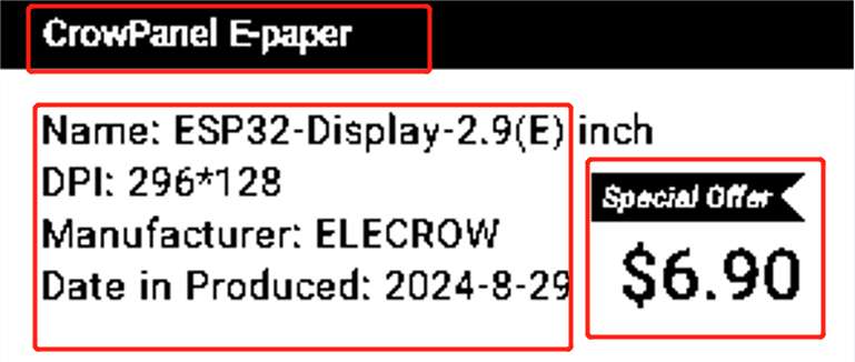

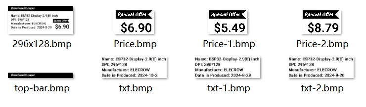

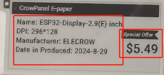

First, let's take a look at the price tag we design in this example, which is divided into three parts(all are images). The top bar is a fixed and unchanging background. On the left is the description, and on the right is the price. The parts we need to update are the description and price.

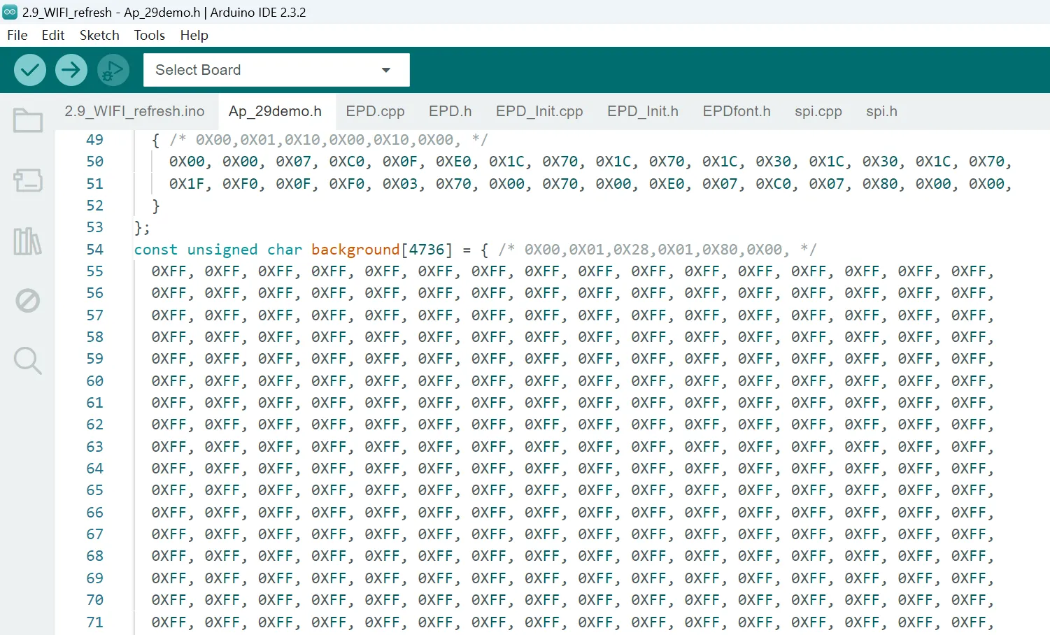

For the fixed top bar, we can convert it to C array and put them in the code.

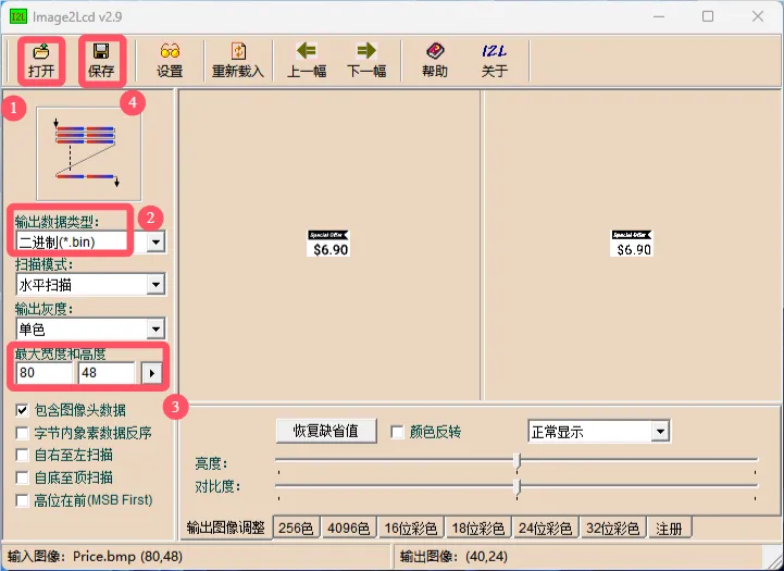

For the variable description and price, we need to convert them to bin file and upload them to the board through WiFi.

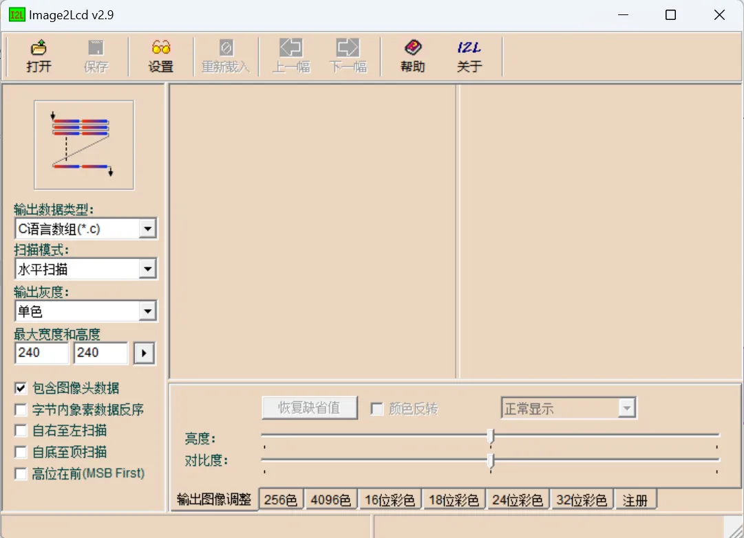

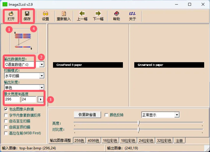

the image modulo tool Image2Lcd and open it.
Click open and select top-bar.bmp, convert it to array format.
- Open file
- Output date type: C language array by default
- The biggest width and height: Consistent with the width and height of the image. Note that it must be a multiple of 8, otherwise it cannot be displayed properly
- Save and output
You can put this array in a suitable header file, and I have placed it in Ap_29demo. h here.
Convert the description pictures and price tag pictures to bin files. These bin files will be used to update prices over WiFi.
- Open the file
- The output type select .bin file
- The width and height should consistent with the width and height of the image. Note that it must be a multiple of 8, otherwise it cannot be displayed properly
- Save the file

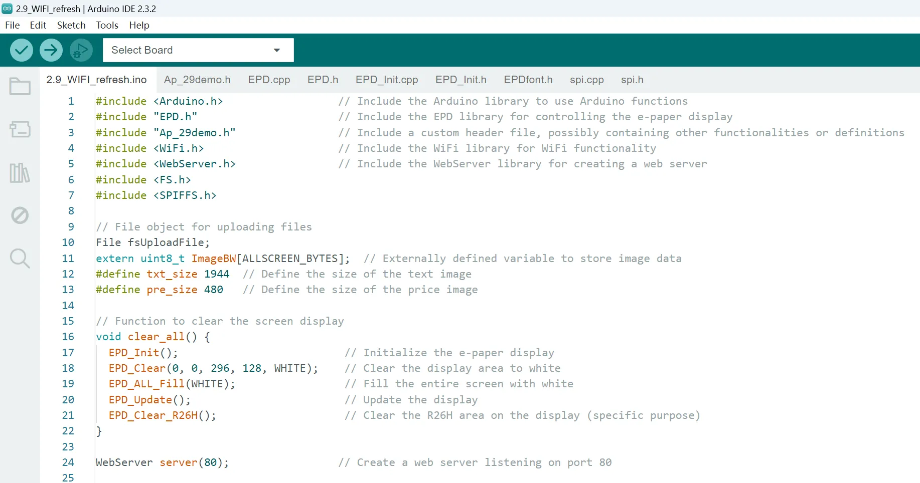

Please click to download the code file 2.9_WIFI_refresh.zip for this demo.
Add necessary libraries
#include <Arduino.h> // Include the Arduino library to use Arduino functions
#include "EPD.h" // Include the EPD library for controlling the e-paper display
#include "Ap_29demo.h" // Include a custom header file, possibly containing other functionalities or definitions
#include <WiFi.h> // Include the WiFi library for WiFi functionality
#include <WebServer.h> // Include the WebServer library for creating a web server
#include <FS.h>
#include <SPIFFS.h>
Define the file variable fsUploadFile Used for accessing files, txt_size and pre_size correspond to the size of the BIN file(Exported in the above steps) for the text label and price label to be transmitted. The image resolution requirement is smaller than the screen resolution and both width and height are multiples of 8.
// File object for uploading files
File fsUploadFile;
extern uint8_t ImageBW[ALLSCREEN_BYTES]; // Externally defined variable to store image data
#define txt_size 1944 // Define the size of the text image
#define pre_size 480 // Define the size of the price image
Note: The size here can be defined based on the size of the images to be transmitted later, otherwise it will cause image transfer failure

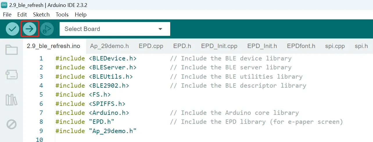

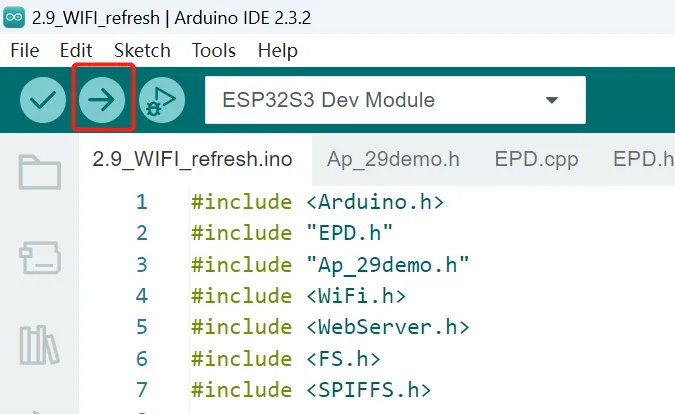

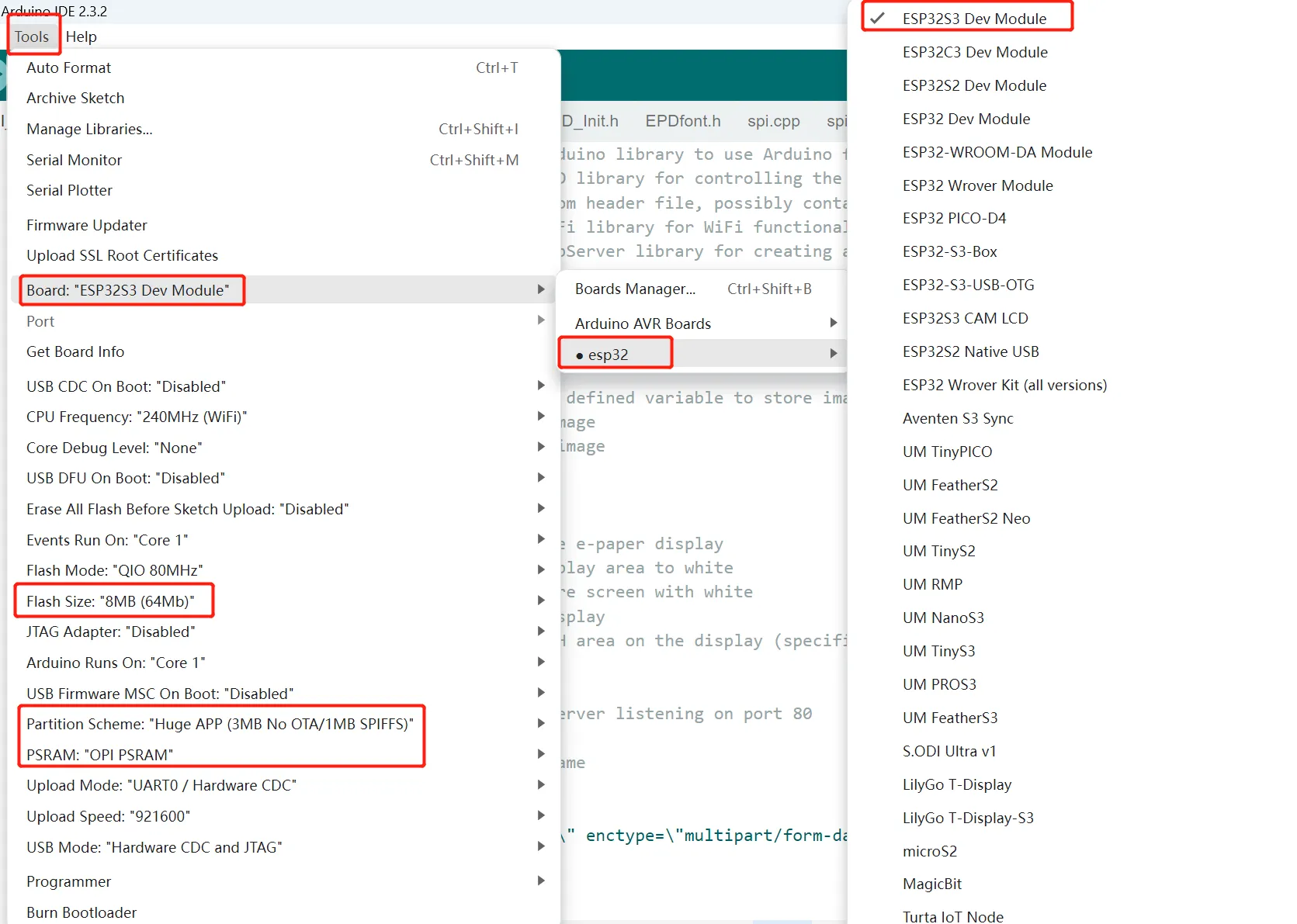

Open the 2.9_WIFI_refresh.ino
Click "Tools"->"Board"->"esp32"->"ESP32S3 Dev Module", and the "Partition Scheme" select "Huge APP (3MB No OTA/1MB SPIFFS)", "PSRAM" select "OPI PSRAM".
Connect CorwPanel to the computer, click on "Tool" and select the corresponding "port".
Click "Upload" to upload the code to the board. There will be an image show on the screen.

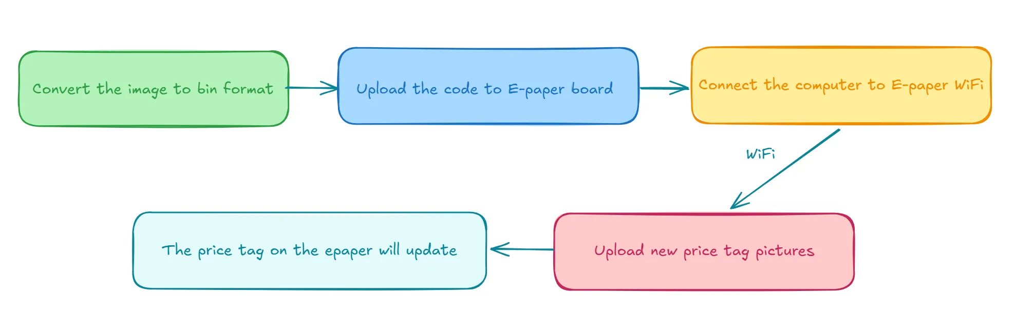

Update the price tag with WiFi¶
Connect a laptop to the hotspot of the ESP32 E-PAPER display.
Enter the IP address 192.168.4.1 in the browser.
Select the bin file of the picture you need to show, then click submit.
Note: The size of the images you transfer must be consistent with the size defined in the code, otherwise it will cause image transfer failure
After successful transmission, the price and text will be replaced, and the data will be saved in flash.

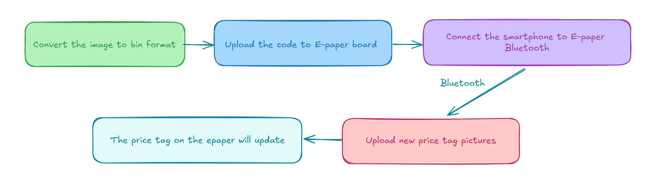

Update via Bluetooth¶
Convert the image format¶
The same as the method in the "Update via WiFi".
Code Explanation¶

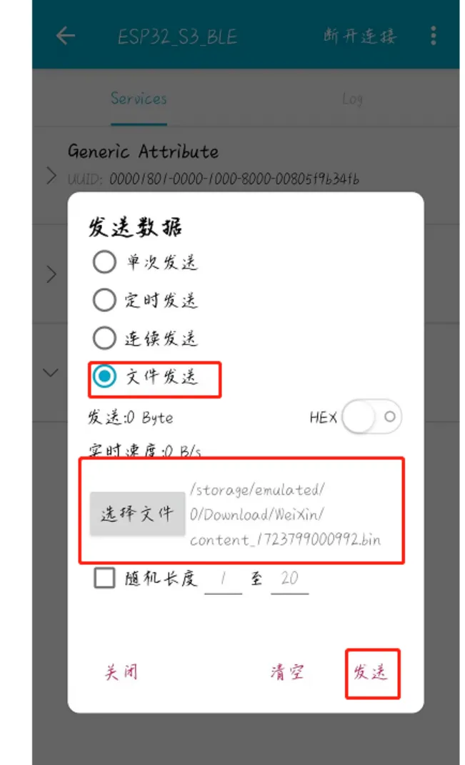

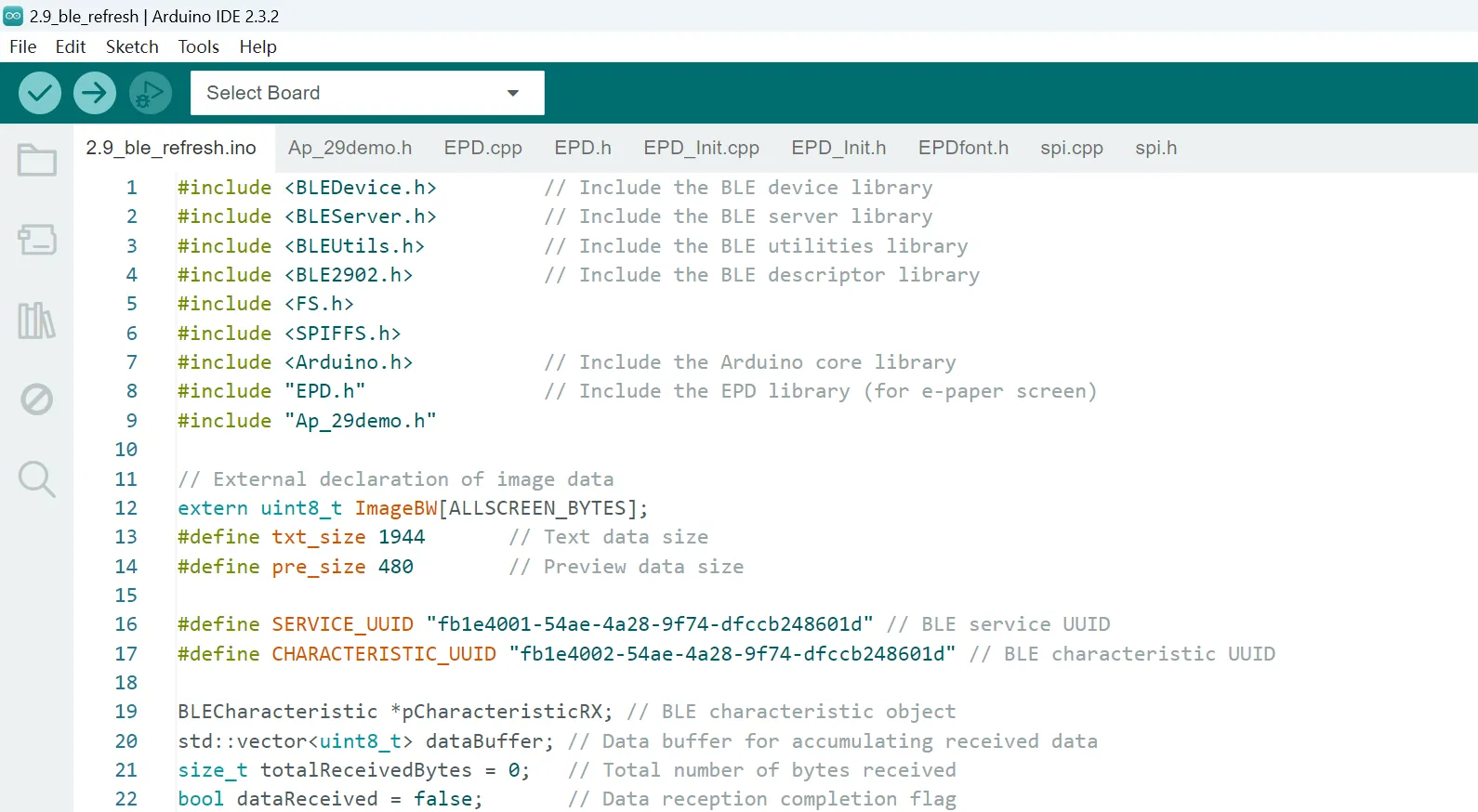

Please click to download the code file 2.9_ble_refresh.zip for this demo.
#include <BLEDevice.h> // Include the BLE device library
#include <BLEServer.h> // Include the BLE server library
#include <BLEUtils.h> // Include the BLE utilities library
#include <BLE2902.h> // Include the BLE descriptor library
#include <FS.h>
#include <SPIFFS.h>
#include <Arduino.h> // Include the Arduino core library
#include "EPD.h" // Include the EPD library (for e-paper screen)
// External declaration of image data
#define txt_size 1944 // Text data size
#define pre_size 480 // Preview data size

class MyCallbacks : public BLECharacteristicCallbacks
Receive the data sent and integrate it together. Receiving the "OK" character indicates that the transmission is complete.
// BLE characteristic callback class
class MyCallbacks : public BLECharacteristicCallbacks {
// Write callback function
void onWrite(BLECharacteristic *pCharacteristic) {
std::string value = pCharacteristic->getValue(); // Get the written data
if (value.length() > 0) {
Serial.printf("."); // Output a dot to the serial port each time data is received
if (value == "OK") {
dataReceived = true; // Set the data reception completion flag
return;
size_t len = value.length();
if (len > 0) {
// Append the received data to the buffer
dataBuffer.insert(dataBuffer.end(), value.begin(), value.end());
totalReceivedBytes += len; // Update the total number of bytes received

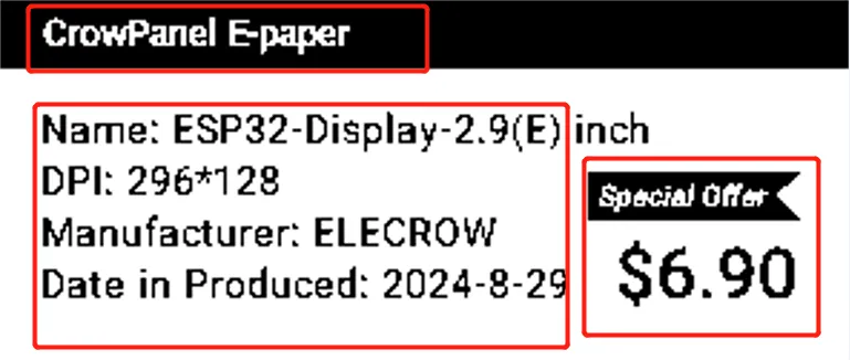

UI_price
Check if the file system has saved UI images, and if so, display them.
// Display the price interface
void UI_price()
EPD_HW_RESET(); // Reset the display
// Display the top background image
EPD_ShowPicture(0, 0, 296, 24, background_top, BLACK); // Display the background image on the screen, with the background color as black
EPD_DisplayImage(ImageBW); // Display the black and white image
EPD_FastUpdate(); // Quickly update the display content
EPD_Sleep(); // Put the display into sleep mode
// Check if the txt.bin file exists
if (SPIFFS.exists("/txt.bin")) {
// The file exists, open the file for reading
File file = SPIFFS.open("/txt.bin", FILE_READ);
if (!file) {
Serial.println("Failed to open file for reading"); // Failed to open the file
return;
// Read data from the file into the array
size_t bytesRead = file.read(txt_formerly, txt_size);
Serial.println("File content:"); // Output the file content to the serial port
while (file.available()) {
Serial.write(file.read()); // Read and print the file content byte by byte
file.close(); // Close the file
flag_txt = 1; // Set the flag to indicate that txt_formerly has been updated
// Display the txt_formerly image
EPD_ShowPicture(10, 30, 216, 72, test1, BLACK);
// Check if the pre.bin file exists
if (SPIFFS.exists("/pre.bin")) {
File file = SPIFFS.open("/pre.bin", FILE_READ);
if (!file) {
return;
size_t bytesRead = file.read(price_formerly, pre_size);
flag_pre = 1; // Set the flag to indicate that price_formerly has been updated
// Display the price_formerly image
EPD_ShowPicture(220, 50, 80, 48, price_formerly, BLACK);

Double click the 2.9_ble_refresh.ino.

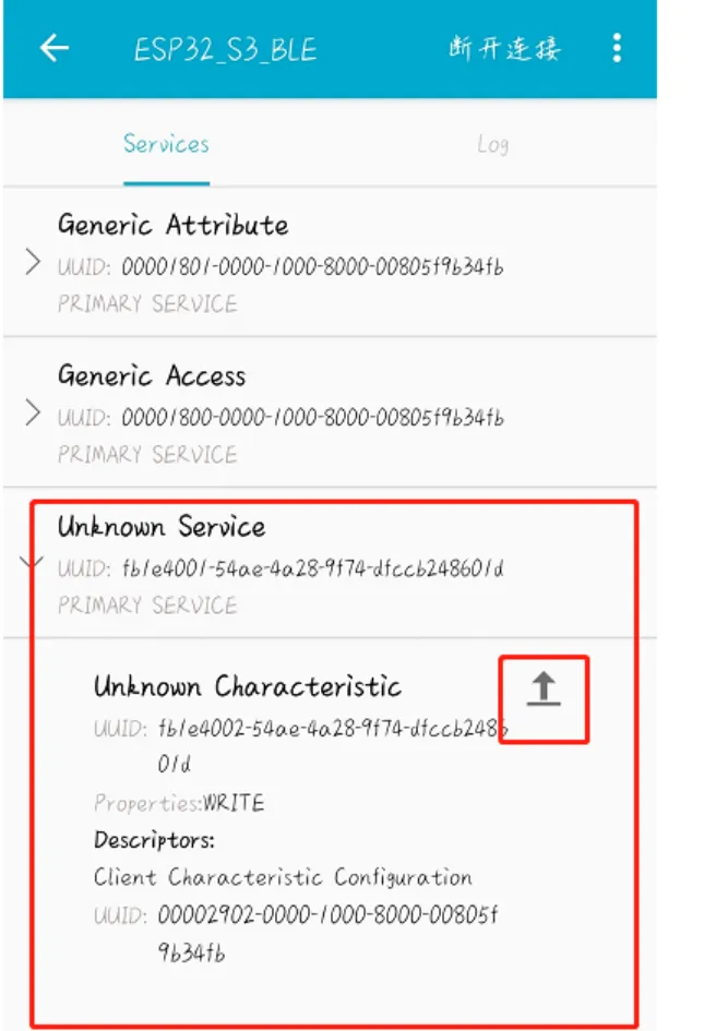

Update the images via bluetooth¶
Download a BLE debugging assistant to your phone, and connect it your phone to the screen device BLE.
Upload the bin file(Save the bin file to your phone in advance).

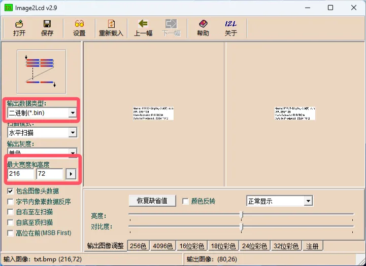

Next, we need to convert these images into a C array format and include it in the code
Click open and select the images, convert them to array format.
- Open file
- Save and output

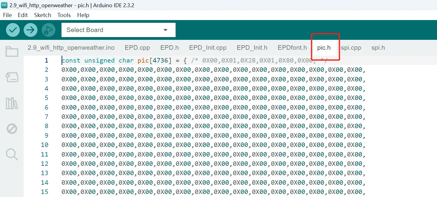

You can put this array in a suitable header file, and I have placed it in pic. h here.

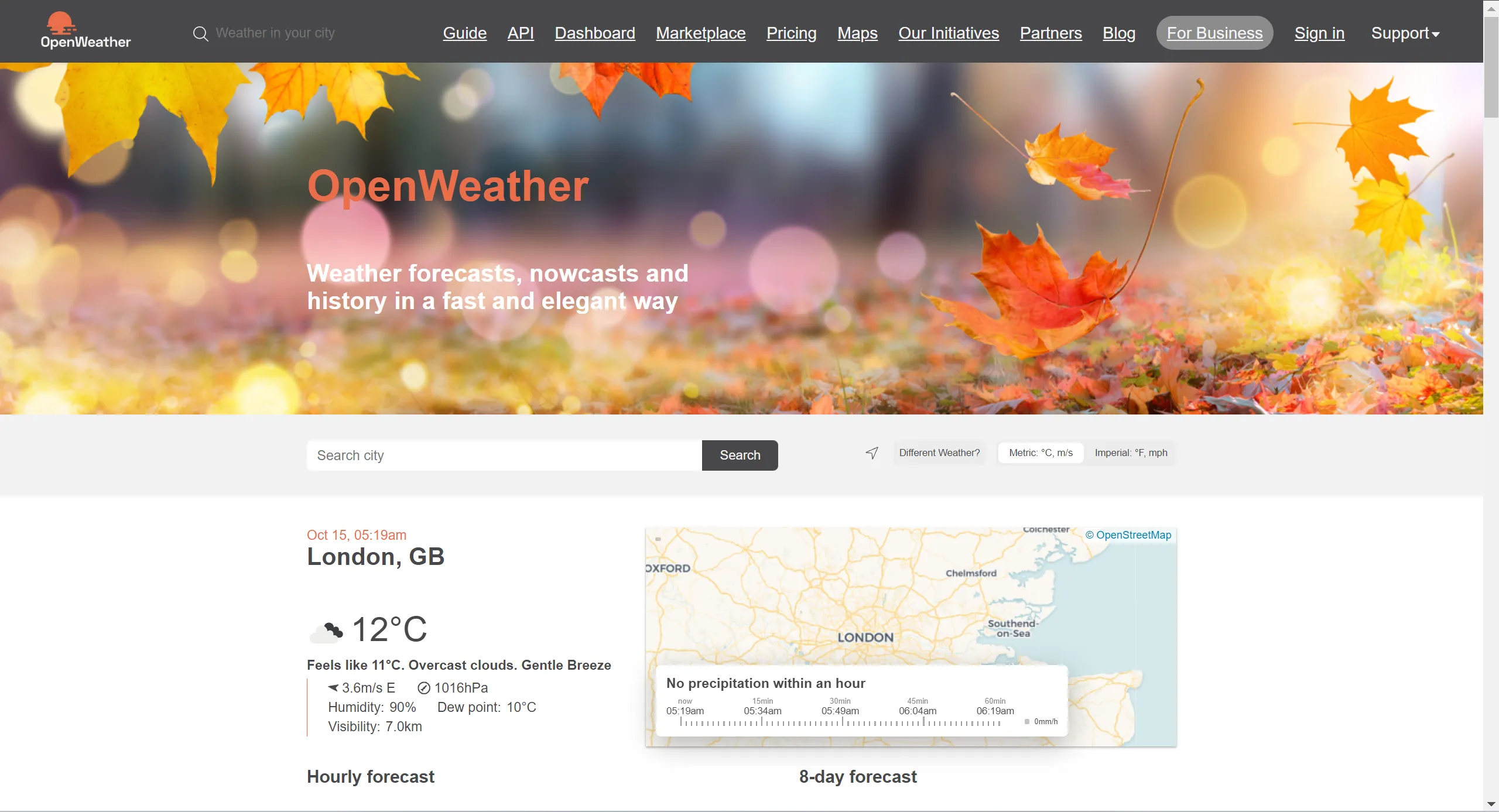

Register an OpenWeather account¶
Enter https://openweathermap.org/ and click "Sing in" to register an OpenWeather account.

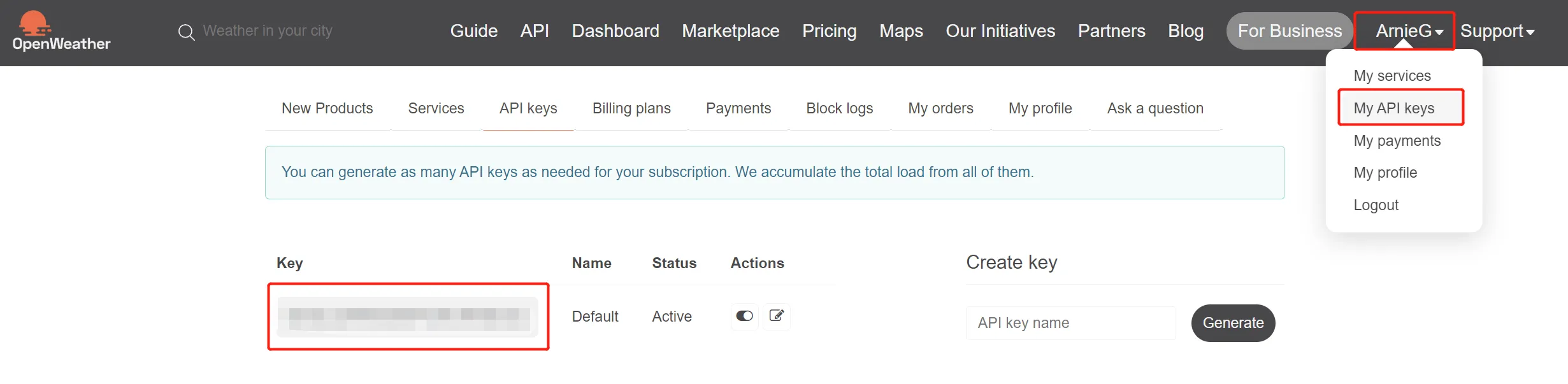

Log in your account.
Click your user name -> "My API Keys" to find your API key.

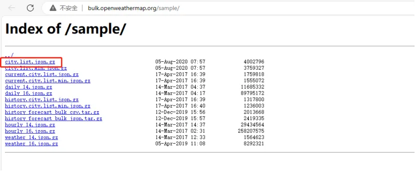

// Replace with city and country code you're in
String city = "London"; // City Name
String countryCode = "2643743"; // Country Code
Country Code
You can find the country code at: http://bulk.openweathermap.org/sample/

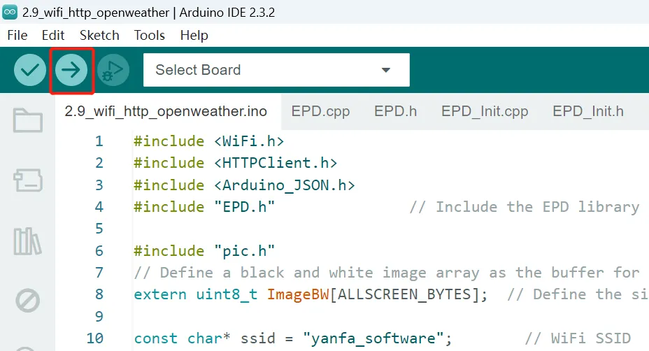

Double click the 2.9_wifi_http_openweather.ino.

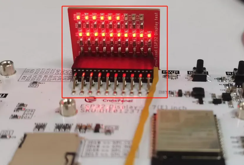

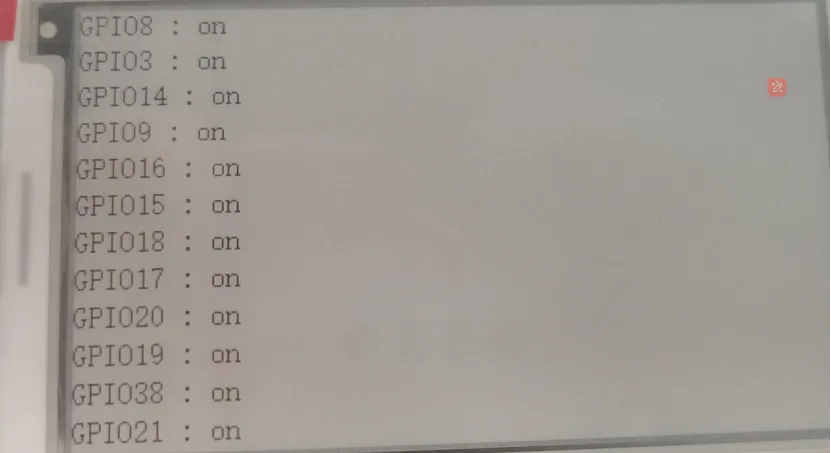

Example 1 Control the GPIO¶
Open the GPIO.ino.
Connect the LED to the GPIO pins.
Upload the code to the CrowPanel. The LEDs will turn on, and the status of the GPIO will show on the screen.

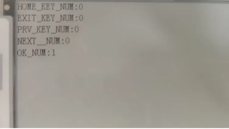

Example 2 Count the times of pressing the keys¶
Open key.ino
Press the button.
The times each button is pressed will be displayed on the screen.

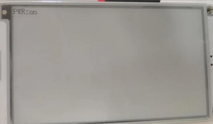

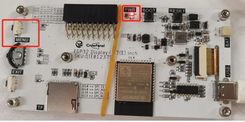

Example 3 Control PWR LED with menu Key¶
Open the PWR.ino
Press the menu key and the PWR LED will turn on/off.

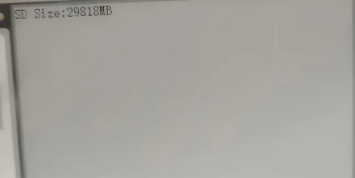

Example 4 Initialize SD card¶
Open TF.ino
Insert the TF card to the card slot.
The size of the TF card will show on the screen.

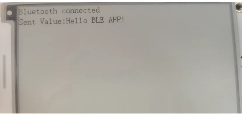

Example 5 Connect Bluetooth¶
Open BLE.ino
After the blutooth is connected, the screen will show:

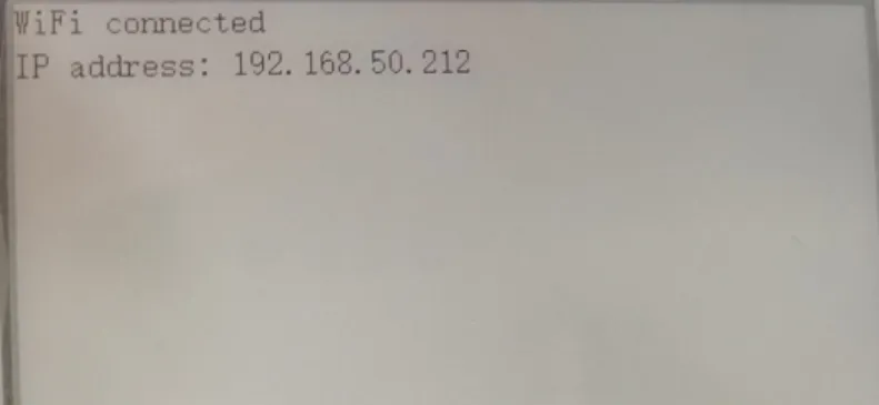

Example 6 Connect WiFi¶
Open wifi.ino
Modify your ssid and password
After the WiFi is connected, the screen will show:

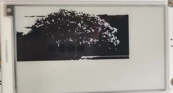

Example 7 Refresh image¶
This example will demonstrate two scenarios: refreshing full screen images and non full screen images.
- Full screen image: The resolution of the image is the same as the screen
- Non full screen image: The image resolution is lower than the screen resolution
Refresch full screen image¶
Open Global_refresh.ino
The image will refresh on the screen.
