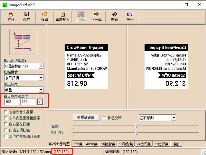

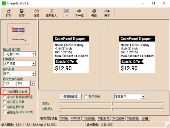

Convert the image format

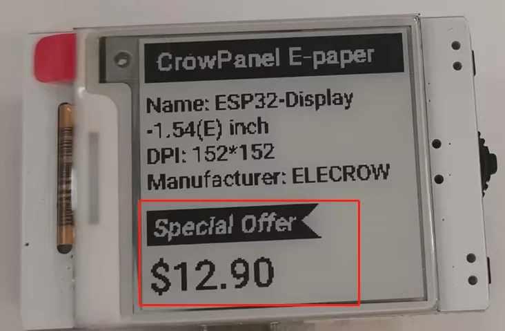

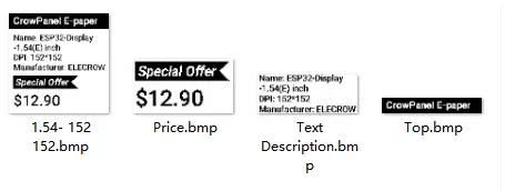

First, let's take a look at the price tag we design in this example, which is divided into three parts(all are images). The top bar is a fixed and unchanging background. On the left is the description, and on the right is the price. The parts we need to update are the description and price.
1.54- 152 152

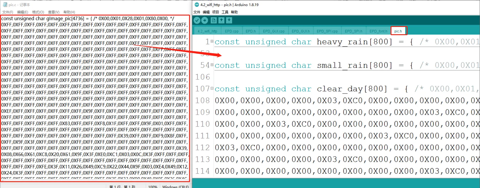

For the fixed top bar, we can convert it to C array and put them in the code.
For the variable description and price, we need to convert them to bin file and upload them to the board through WiFi.
  1. downloadthe price tag pictures. thepricetagpictures

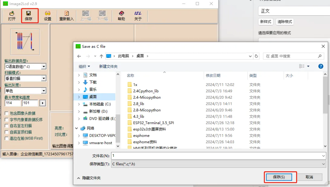

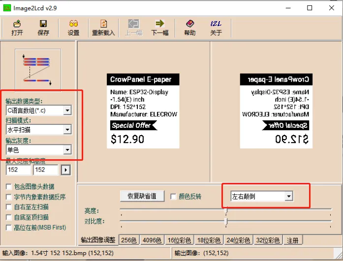

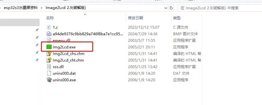

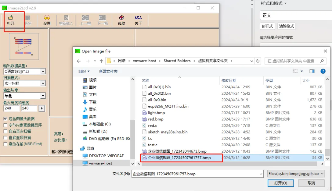

  2. download the image modulo tool Image2Lcd and open it. imagelcd
  3. Open the Bitmap Conversion Software. Open_the_Bitmap
  4. Select the Image for Bitmap Conversion. top-bar

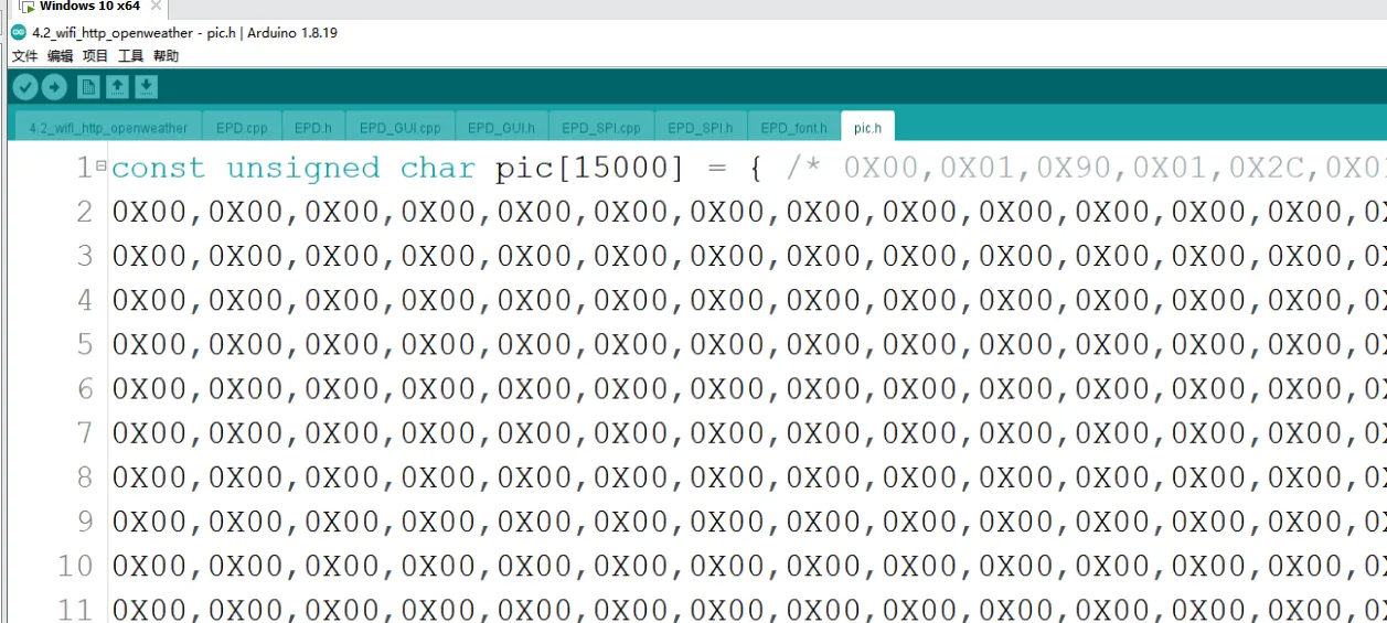

  5. Select Bitmap Conversion Settings: Set Maximum Width and Height to Image Resolution, Mismatched Output Dimensions May Cause Display Issues. Bitmap_Conversion_Settings
    Select Output Type as C Language Array, Set Scan Mode to Horizontal Scan, Output Grayscale as Monochrome, and Flip Image Horizontally.
    Flip_Image_Horizontally
    Do Not Include Image Header Data.
    Image_Header
    Note: The Image Resolution Width and Height Must Be Divisible by 8, Otherwise It Cannot Be Displayed.
    Save the Image, Choose a Location, Enter a Filename, and Save.
    Choose_Location

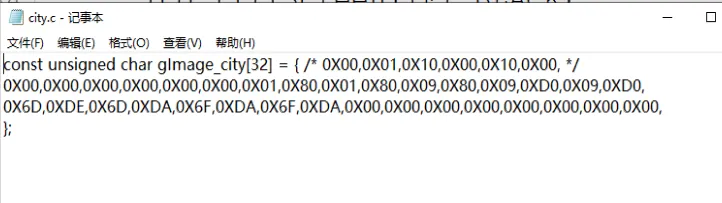

    Generate a .txt File and Copy the C Array Code into the Required Project.
    Required_Project
    Call the Code in Your Program to Display the Image on the Screen.
    Screen

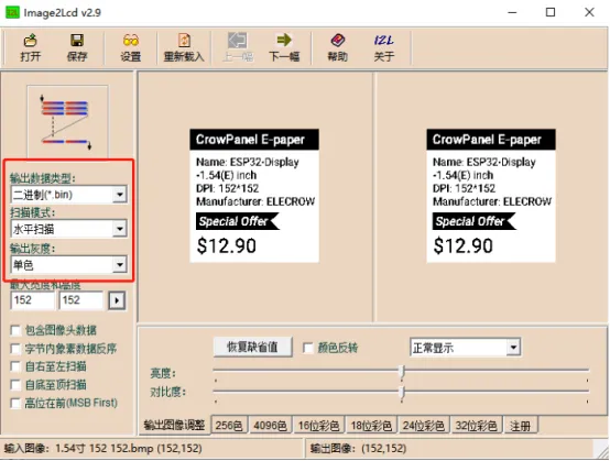

  6. Convert the description pictures and price tag pictures to bin files. These bin files will be used to update prices over WiFi.
    • Open the file
    • The output type select .bin file
    • Select the modeling configuration, where the maximum width and height should match the image's resolution. If the output resolution does not match the image's original resolution, it will cause the image to display incorrectly.
      image-haigeniubi1
      Select the output type as a Bin file, set the scanning mode to horizontal scanning, and choose monochrome for the grayscale output.
      image-haigeniubi2
      Do not include the image header data.
      image-haigeniubi3
      Note: The resolution width and height of the image must be divisible by 8, otherwise, it cannot be displayed properly.
    • Save the file

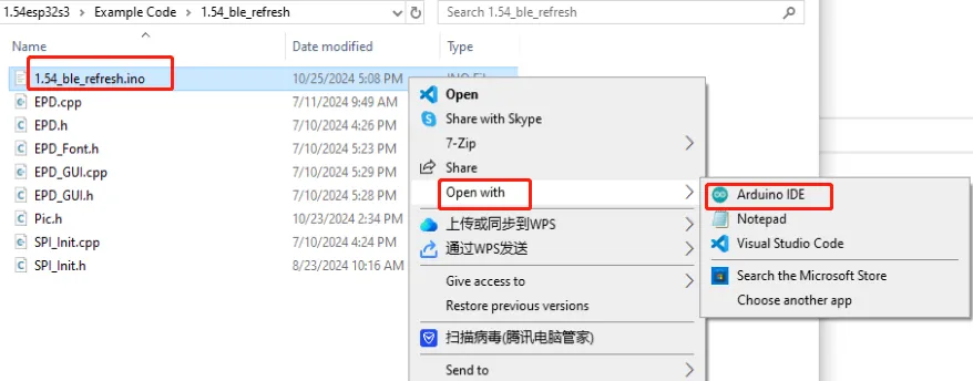

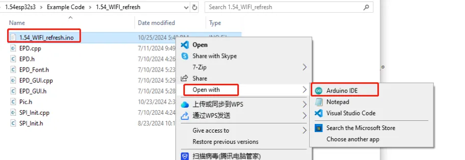

  1. Open the 1.54_WIFI_refresh.ino
    image-20250328153208436

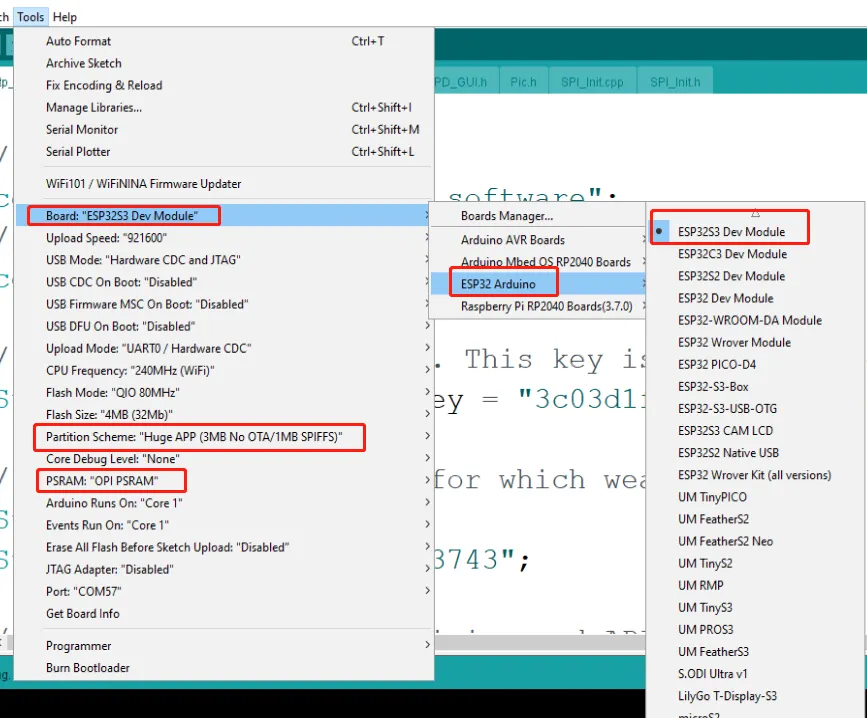

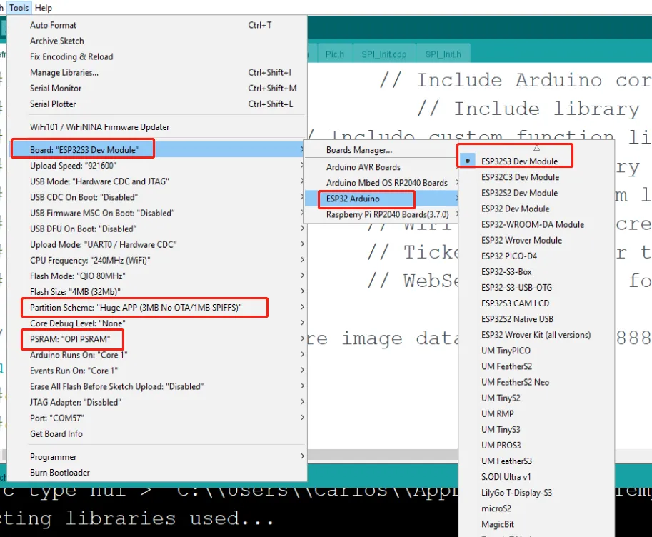

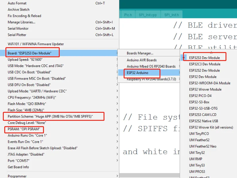

  2. Click "Tools"->"Board"->"esp32"->"ESP32S3 Dev Module", and the "Partition Scheme" select "Huge APP (3MB No OTA/1MB SPIFFS)", "PSRAM" select "OPI PSRAM".
    Module
  3. Connect CorwPanel to the computer, click on "Tool" and select the corresponding "port".
  4. Click "Upload" to upload the code to the board. There will be an image show on the screen.

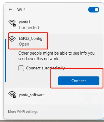

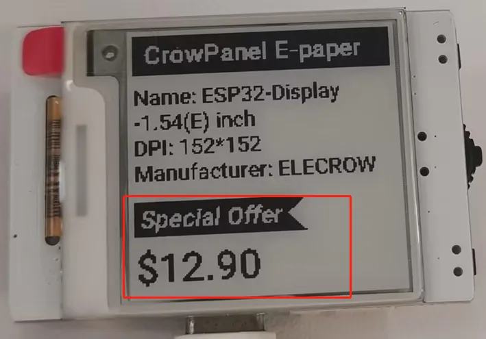

Update the price tag with WiFi
  1. Connect a laptop to the hotspot of the ESP32 E-PAPER display.
  2. Enter the IP address 192.168.4.1 in the browser.
  3. Select the bin file of the picture you need to show, then click submit.
Note: The size of the images you transfer must be consistent with the size defined in the code, otherwise it will cause image transfer failure
After successful transmission, the price and text will be replaced, and the data will be saved in flash.

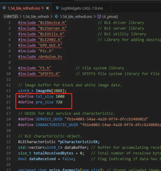

Define the file variable fsUploadFile Used for accessing files, txt_size and pre_size correspond to the size of the BIN file(Exported in the above steps) for the text label and price label to be transmitted. The image resolution requirement is smaller than the screen resolution and both width and height are multiples of 8
File fsUploadFile;              // File object for uploading
#define txt_size 1008
#define pre_size 728
Note: The size here can be defined based on the size of the images to be transmitted later, otherwise it will cause image transfer failure

UI_price
Check if the file system has saved UI images, and if so, display them.
// User interface function to display price information.
void UI_price() {
    EPD_HW_RESET();
    EPD_ShowPicture(0, 0, 24, 152, gImage_top, BLACK); // Display picture on screen.
    if (SPIFFS.exists("/txt.bin")) {
        // File exists, read its content.
        File file = SPIFFS.open("/txt.bin", FILE_READ);
        if (!file) {
            Serial.println("Unable to open file for reading.");
            return;
        // Read file data into an array.
        size_t bytesRead = file.read(txt_formerly, txt_size);
        Serial.println("File content:");
        while (file.available()) {
            Serial.write(file.read());
        file.close();
        EPD_ShowPicture(32, 10, 56, 144, txt_formerly, BLACK);
    if (SPIFFS.exists("/pre.bin")) {
        File file = SPIFFS.open("/pre.bin", FILE_READ);
        if (!file) {
            return;
        size_t bytesRead = file.read(price_formerly, pre_size);
        file.close();
        EPD_ShowPicture(96, 50, 52, 104, price_formerly, BLACK);
    EPD_Display(ImageBW);
    EPD_FastUpdate();
    EPD_DeepSleep();

Upload the Code
  1. Double click the 1.54_ble_refresh.ino.
    Ble_refresh
    OPI_PSRAM
    Upload

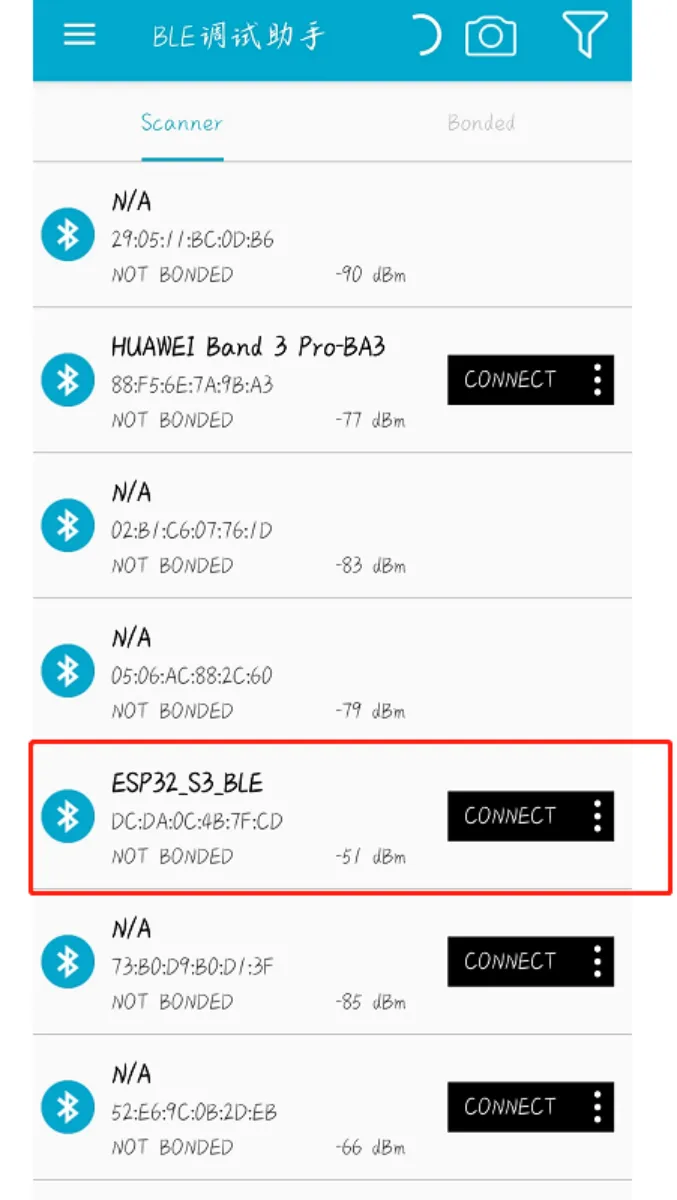

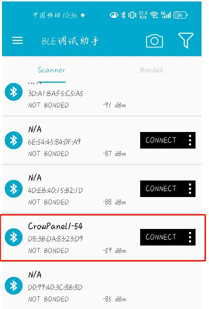

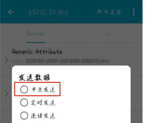

Update the images via bluetooth
  1. Download a BLE debugging assistant to your phone, and connect it your phone to the screen device BLE.
    connect-ble
  2. Upload the bin file(Save the bin file to your phone in advance).
  3. Select the image to send, and after successful transmission, the screen will display the sent image.
    4
    Note: The transmitted image must match the one defined in the code.
    After the data transmission is complete, send "OK" to indicate the end of the transmission.
  4. After successful transmission, the price and text will be replaced, and the data will be saved in flash.

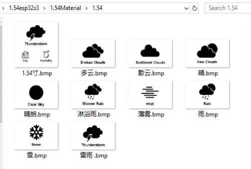

    downloadthe icons.
  4. To convert UI images into C files for use in your program's refresh
    The generated array can be directly copied into the project for use.

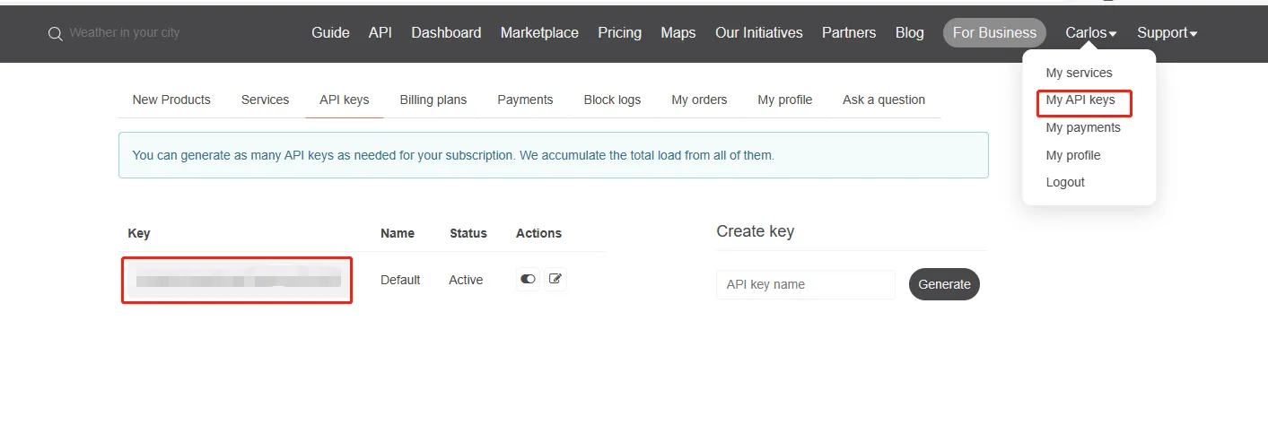

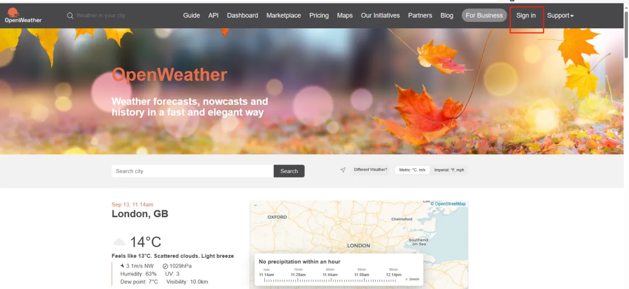

Register an OpenWeather account
  1. Enter https://openweathermap.org/ and click "Sing in" to register an OpenWeather account.
  2. Log in your account.
  3. Click your user name -> "My API Keys" to find your API key.

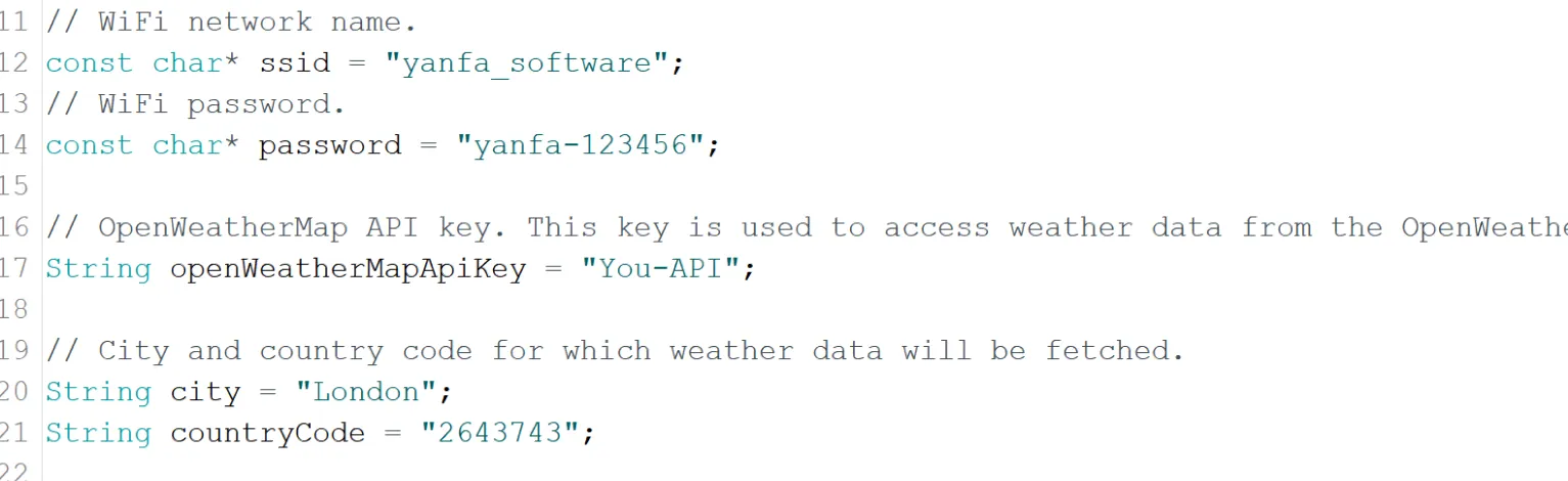

Modify your information
   // WiFi network name.
   const char* ssid = "yanfa_software";
   // WiFi password.
   const char* password = "yanfa-123456";
   // OpenWeatherMap API key. This key is used to access weather data from the OpenWeatherMap API.
   String openWeatherMapApiKey = "3c03d1f4e2dd3e14474a9a3a2f2299ff";
   // City and country code for which weather data will be fetched.
   String city = "London";
   String countryCode = "2643743";

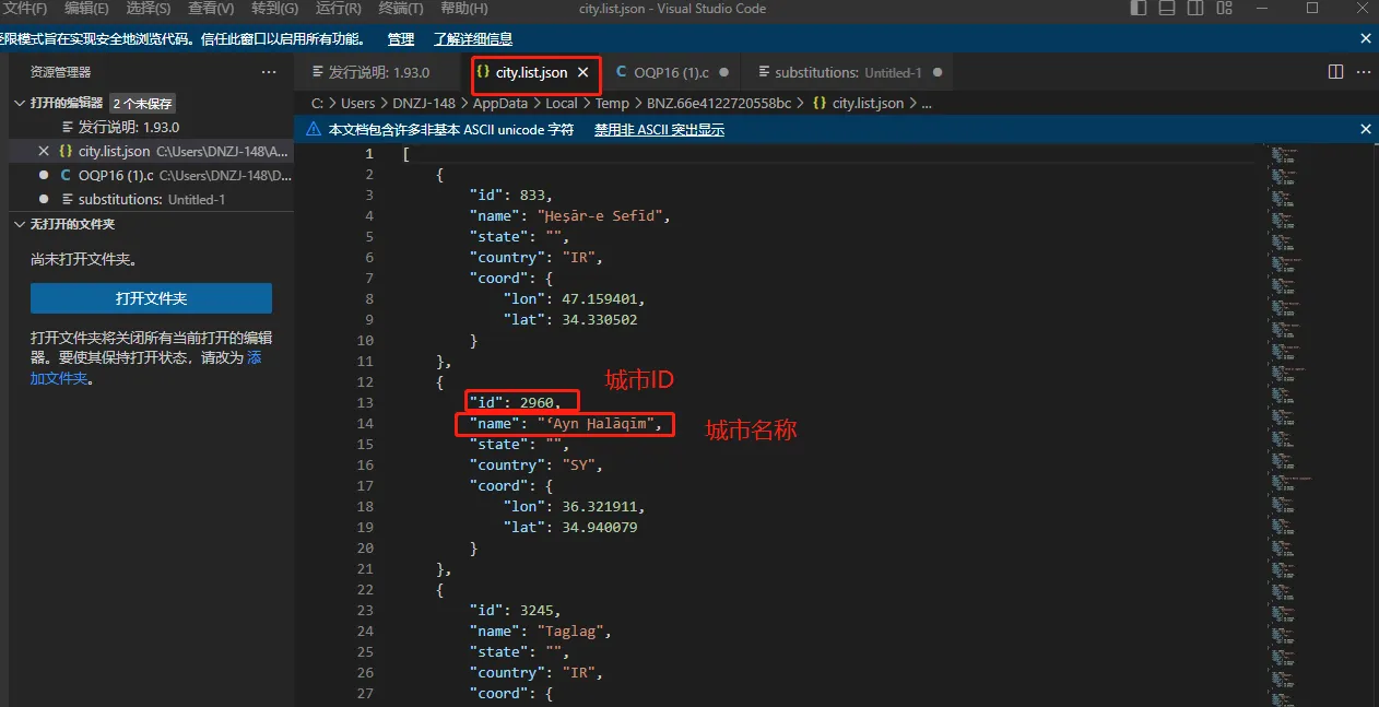

Country Code
You can find the country code at: http://bulk.openweathermap.org/sample/
Replace the information with the following code.

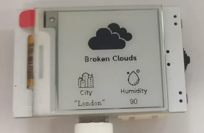

UI_weather_forecast
Display the processed data saved in the variable on the screen.
   // Function to display weather forecast on the e-paper display.
   void UI_weather_forecast()
       char buffer[40];
       EPD_HW_RESET();
       // Display a background picture on the e-paper.
       EPD_ShowPicture(0, 0, 152, 152, pic, BLACK);
       // Display the weather icon based on the weather_flag.
       EPD_ShowPicture(4, 2, 88, 144, Weather_Num[weather_flag], BLACK);
       EPD_FastUpdate();
       EPD_DeepSleep();

  1. Double click the 1.54_wifi_http_openweather.ino.

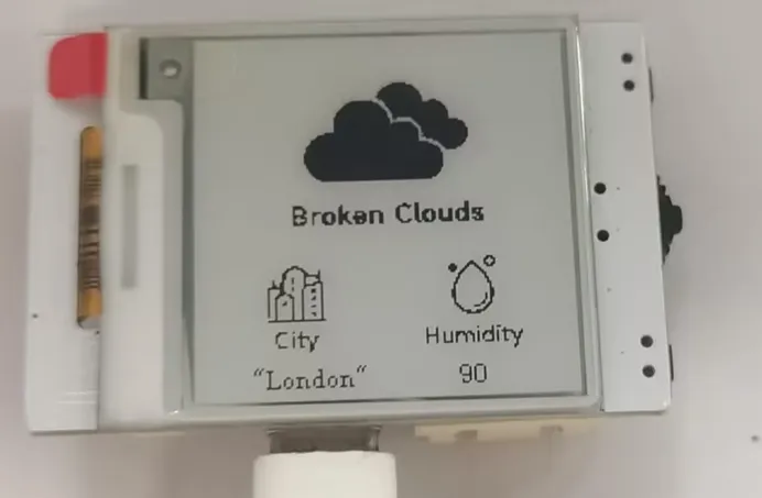

  5. After downloading, the weather information for the city you have selected will be displayed on CrowPanel.
Example Effect Description

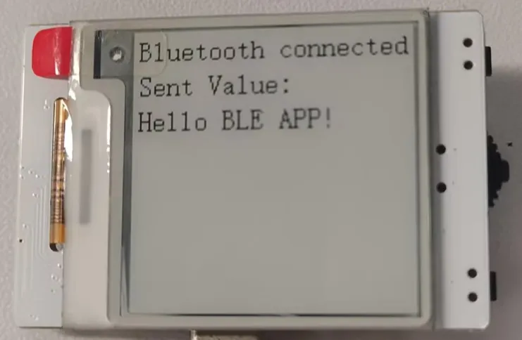

  1. BLE Example Effect:
    Select a BLE debugging app to search and connect.
    Select a BLE debugging app to search for and connect to the device.
    After a successful connection, the status will be displayed.

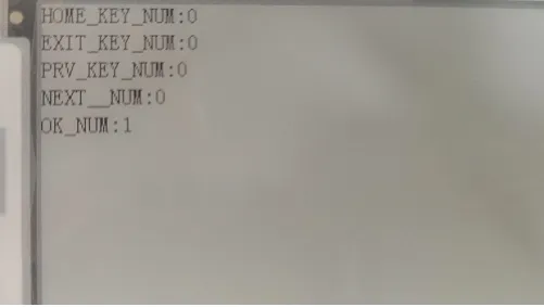

  2. Key Example Effect: The screen displays the number of button presses in real time.

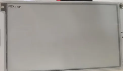

  3. PWR Example Effect: Press the "Menu" key to control the on/off state of the PWR LED, and display the status on the screen.
