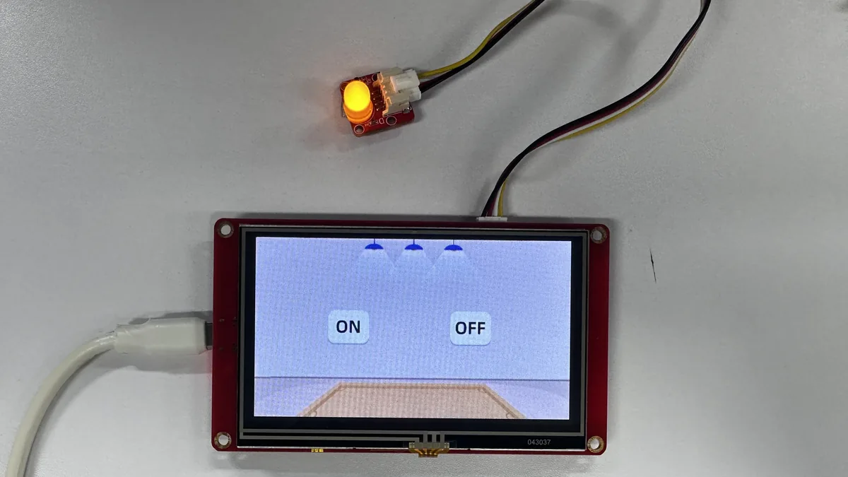

This example tutorial is a project for controlling the on and off of an LED. It demonstrates how to create a UI and how to control the on and off of an LED through buttons on the screen.

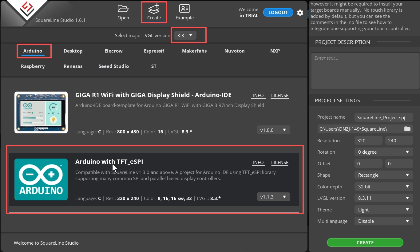

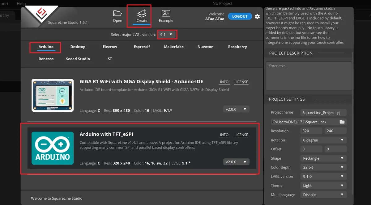

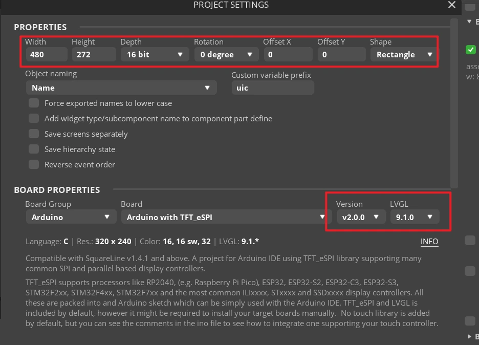

In the earlier version of SLS, select "Arduino"->"Arduino with TFT_eSPI".
Note:

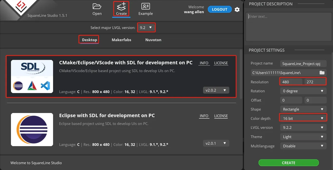

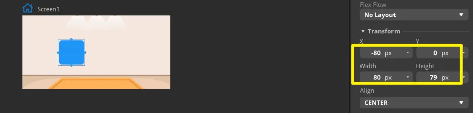

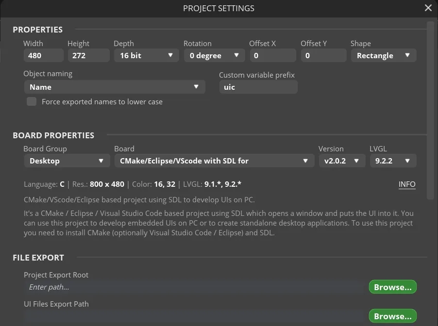

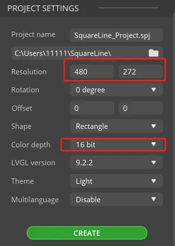

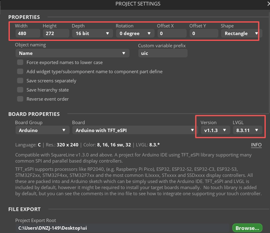

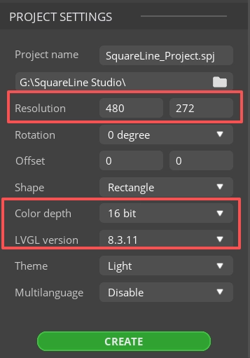

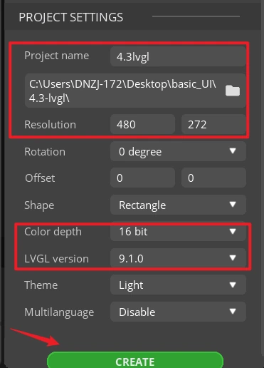

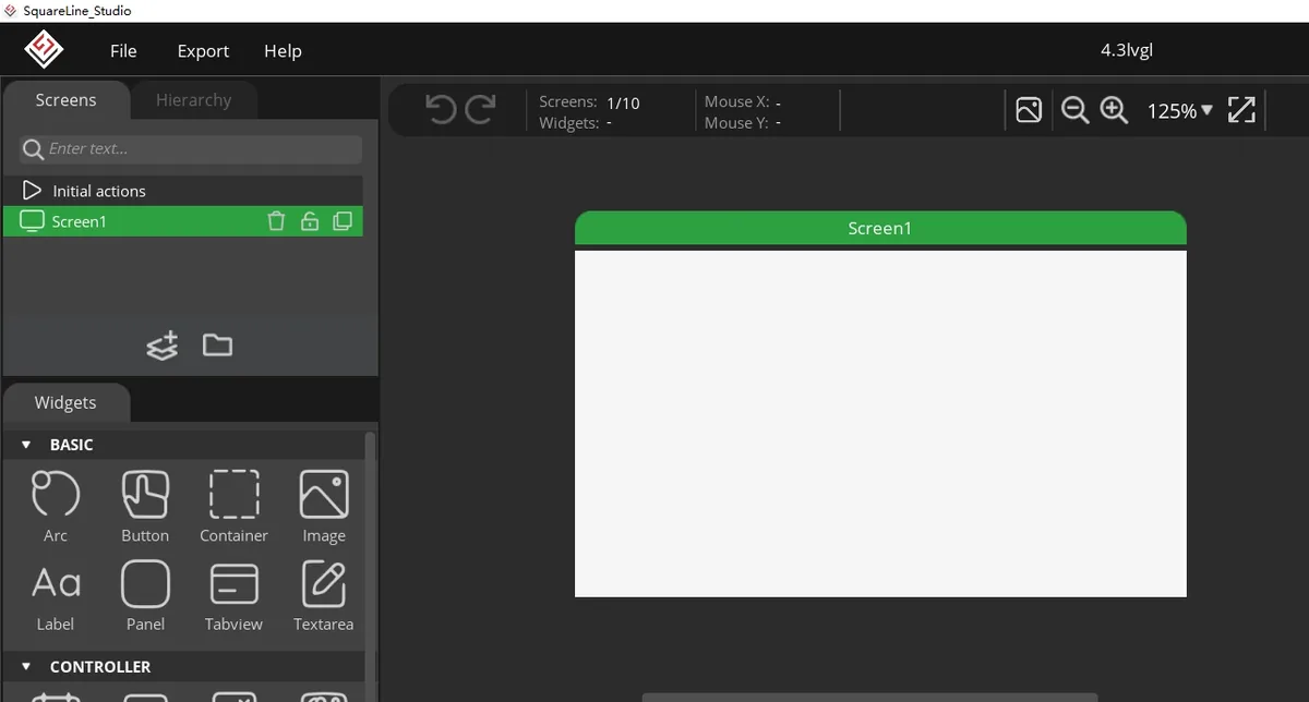

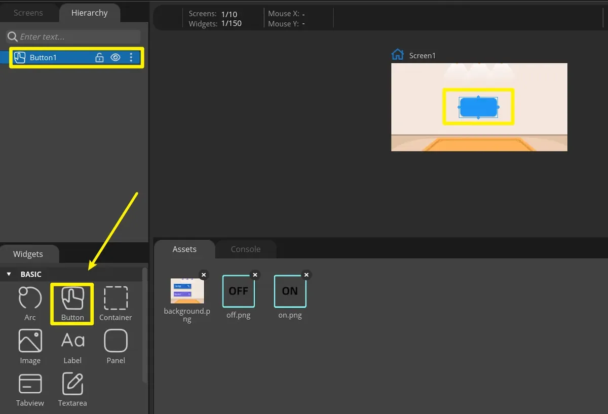

Set the name of the project, set the screen resolution to 480*272, set the color depth to 16bit, and keep other default settings. After setting, click CREATE to create the project.

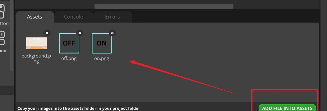

Please click
to download the custom images used in this tutorial.
Note:

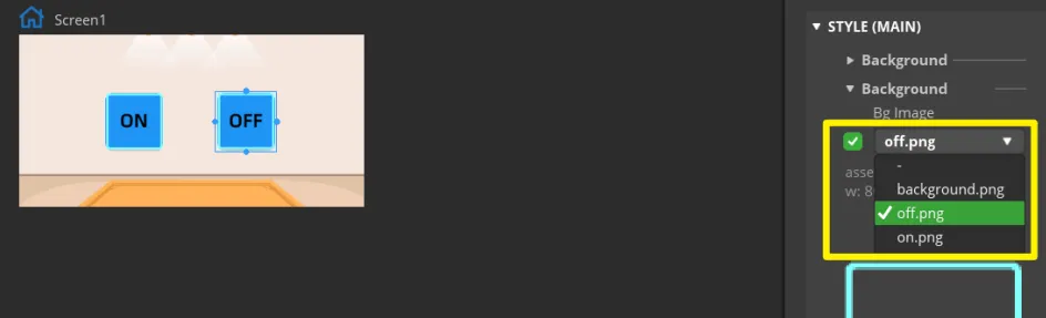

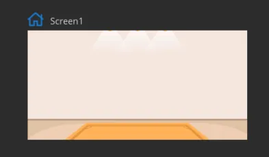

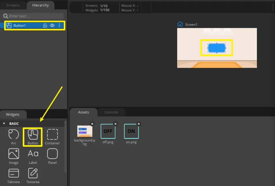

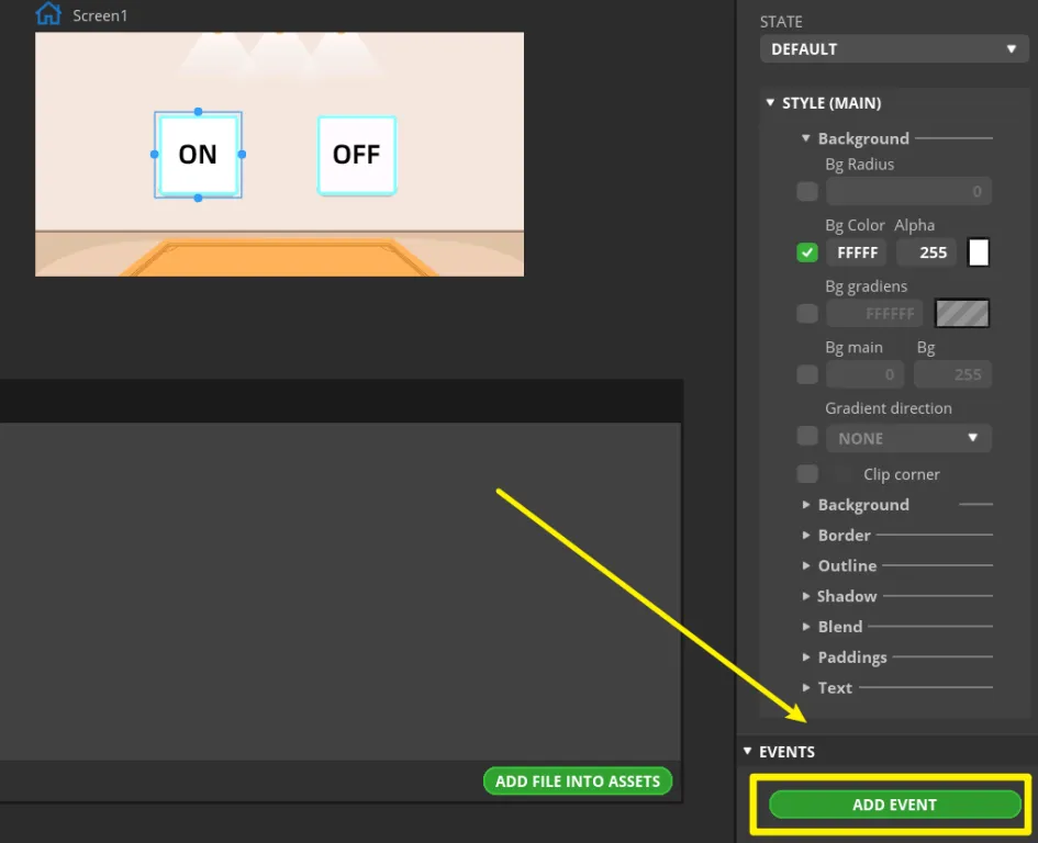

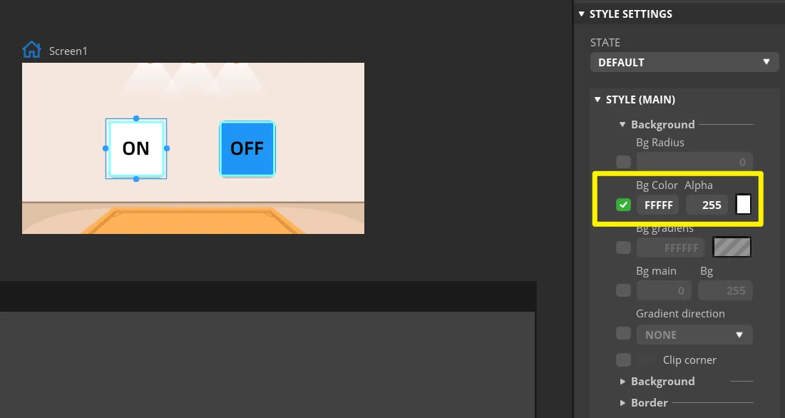

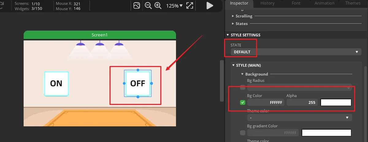

Add background.

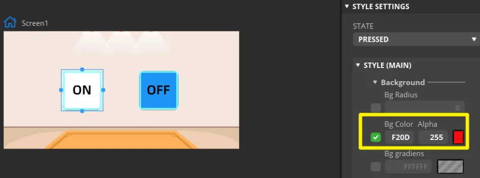

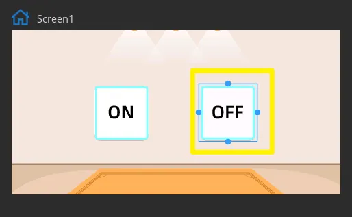

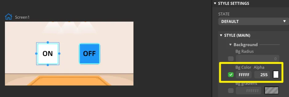

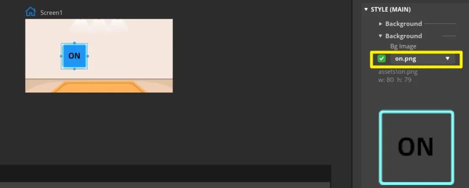

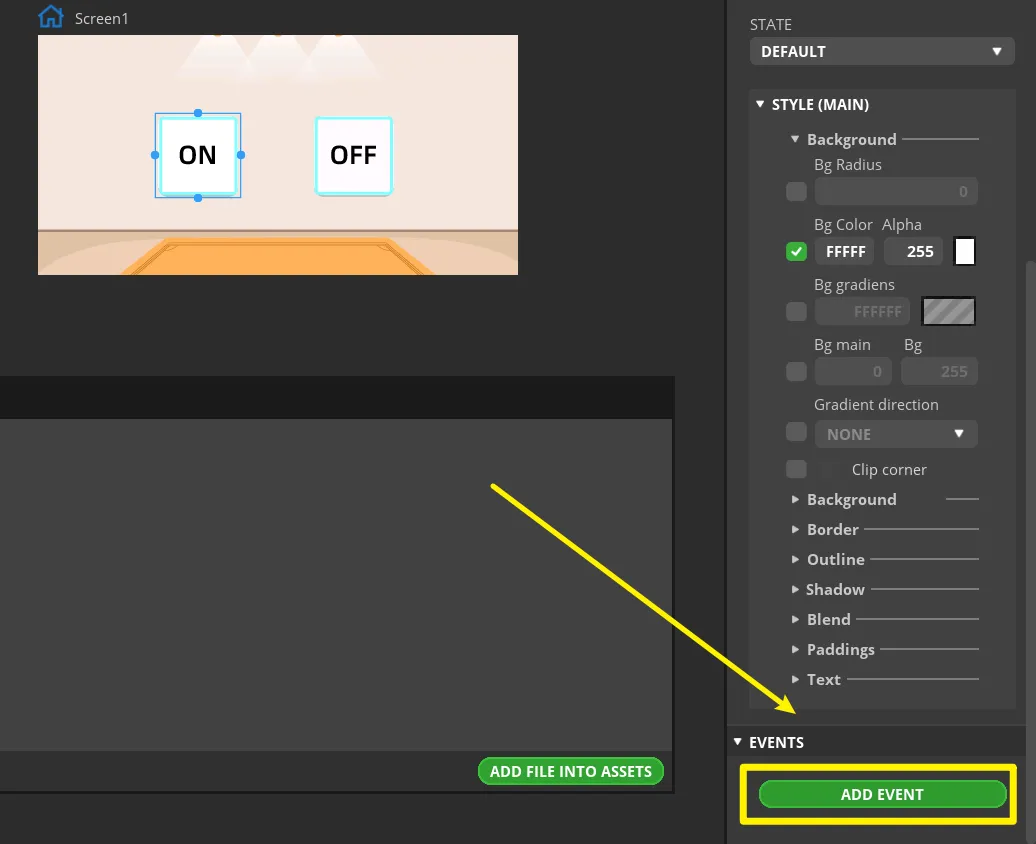

Add events to buttons.
Select "clicked" as the trigger condition, select a trigger event in "Action". It will be modified in the generated program to achieve the LED control function.

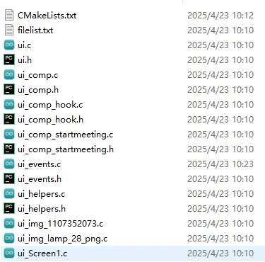

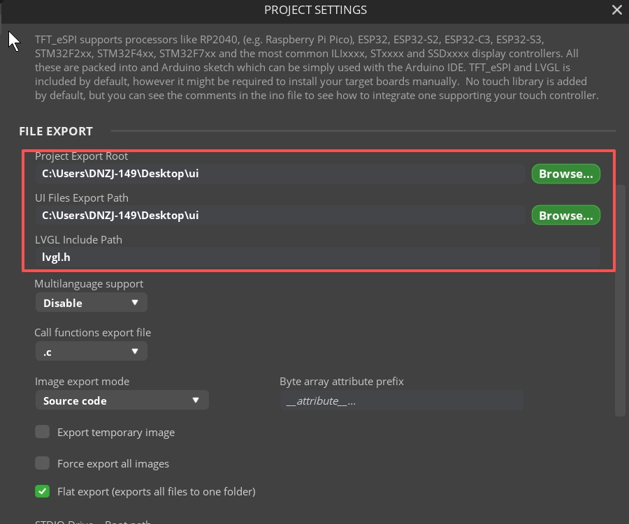

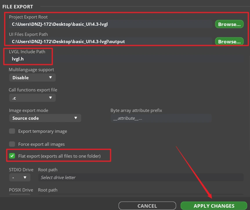

Export UI files.
Then click "APPLY CHANGES".

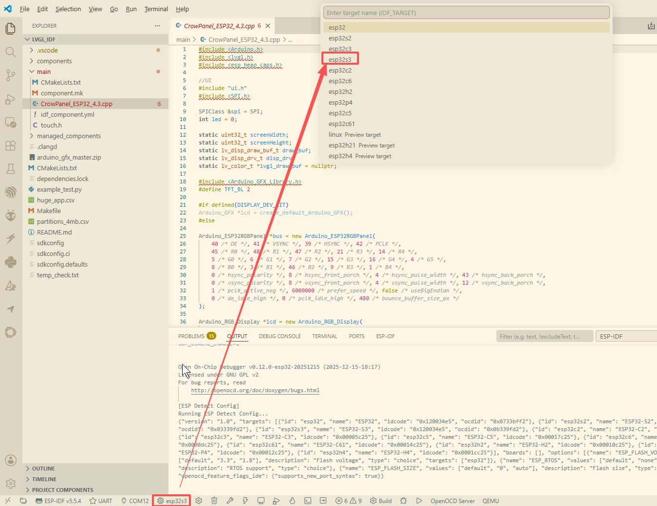

Build the Project with ESP-IDF¶

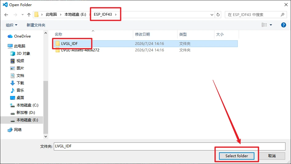

Get Started with ESP-IDF¶
Please click the card below to learn how to install ESP-IDF. Create a blank project according to the "Get Started with ESP-IDF".
You can click to download the complete project we provided. This project can be used directly. You can also create the project by following the tutorial.

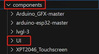

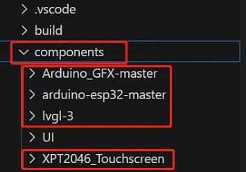

Create a new folder and name the folder 'components'. Add the libraries we provided to this folder.
Please click to download the libraries we provided.

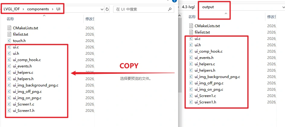

Setup UI file¶
Add the UI file we exported earlier in Squareline.

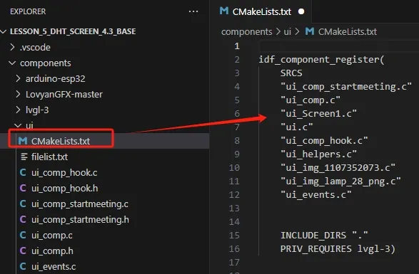

The CMakeList.txt file in the UI file needs to be modified as follows:
Before modification
SET(SOURCES ui_comp_button2.c
ui_comp.c
ui_Screen1.c
ui.c
ui_comp_hook.c
ui_helpers.c
ui_events.c
ui_img_background_png.c
ui_img_on_png.c
ui_img_off_png.c)
add_library(ui${SOURCES})
After modification
Define a variable in the ui.h file. In the main program by judging the value of this variable, control the LED light on and off.
Locate the FUNCTION location in the ui.c file. This is the code we generated when we added events to squareline. We modify the event implementation function to what we need.
Delete the code in the red circle in the image above. Add new code to assign values to led variables.
When the key 1 (ON key) is pressed, set the LED value to 1.
When key 2 (OFF key) is pressed, set the LED value to 0.

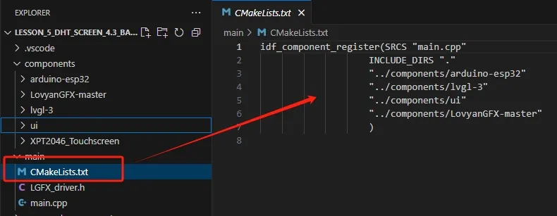

The CMakeList.txt file contains the Settings for the library. All required libraries should be included by directory address.
The main program is written in CrowPanel_ESP32_4.3.cpp file.

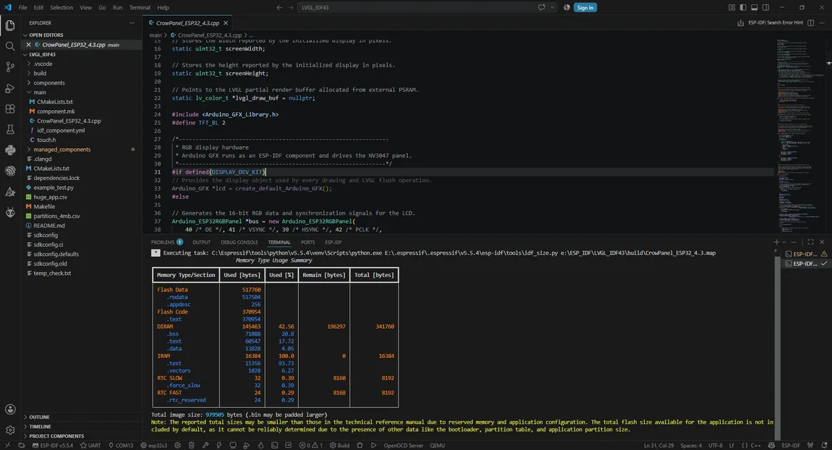

#if defined(DISPLAY_DEV_KIT) Arduino_GFX *lcd = create_default_Arduino_GFX(); #else /* !defined(DISPLAY_DEV_KIT) */ Arduino_ESP32RGBPanel *bus = new Arduino_ESP32RGBPanel( GFX_NOT_DEFINED /* CS */, GFX_NOT_DEFINED /* SCK */, GFX_NOT_DEFINED /* SDA */, 40 /* DE */, 41 /* VSYNC */, 39 /* HSYNC */, 42 /* PCLK */, 45 /* R0 */, 48 /* R1 */, 47 /* R2 */, 21 /* R3 */, 14 /* R4 */, 5 /* G0 */, 6 /* G1 */, 7 /* G2 */, 15 /* G3 */, 16 /* G4 */, 4 /* G5 */, 8 /* B0 */, 3 /* B1 */, 46 /* B2 */, 9 /* B3 */, 1 /* B4 */ ); // option 1: // ILI6485 LCD 480x272 Arduino_RPi_DPI_RGBPanel *lcd = new Arduino_RPi_DPI_RGBPanel( bus, 480 /* width */, 0 /* hsync_polarity */, 8 /* hsync_front_porch */, 4 /* hsync_pulse_width */, 43 /* hsync_back_porch */, 272 /* height */, 0 /* vsync_polarity */, 8 /* vsync_front_porch */, 4 /* vsync_pulse_width */, 12 /* vsync_back_porch */, 1 /* pclk_active_neg */, 7000000 /* prefer_speed */, true /* auto_flush */); #endif /* !defined(DISPLAY_DEV_KIT) */
It uses a class called Arduino_ESP32RGBPanel to initialize a display bus object bus. This object is used to control the ESP32-based RGB display panel. Then, according to option 1 in the comments, it uses the Arduino_RPi_DPI_RGBPanel class to initialize a display object called lcd. This object is used to control an ILI6485 LCD with a resolution of 480x272 pixels.

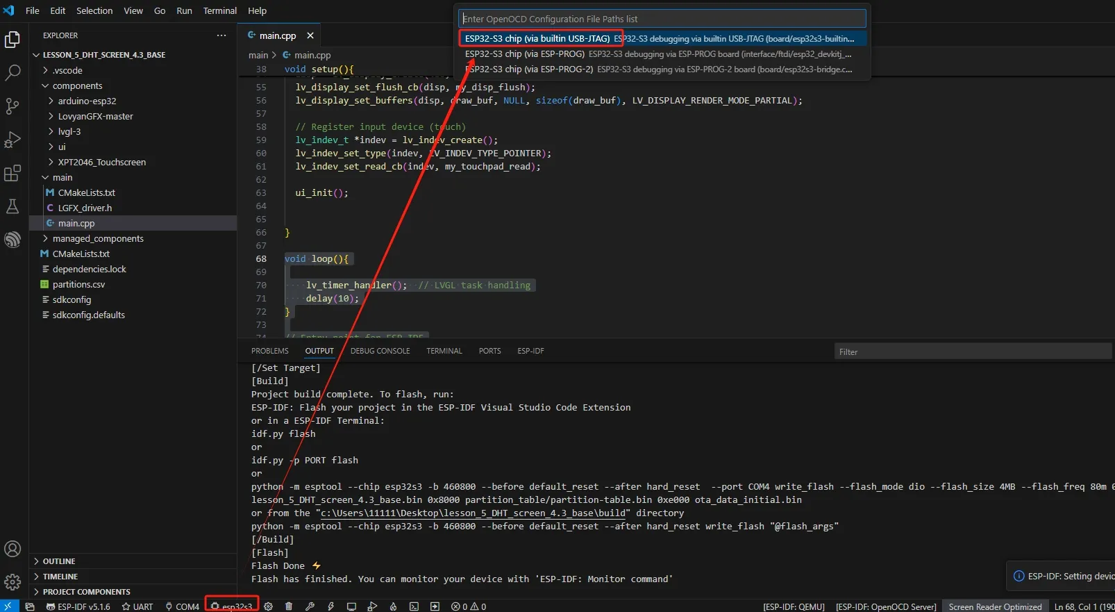

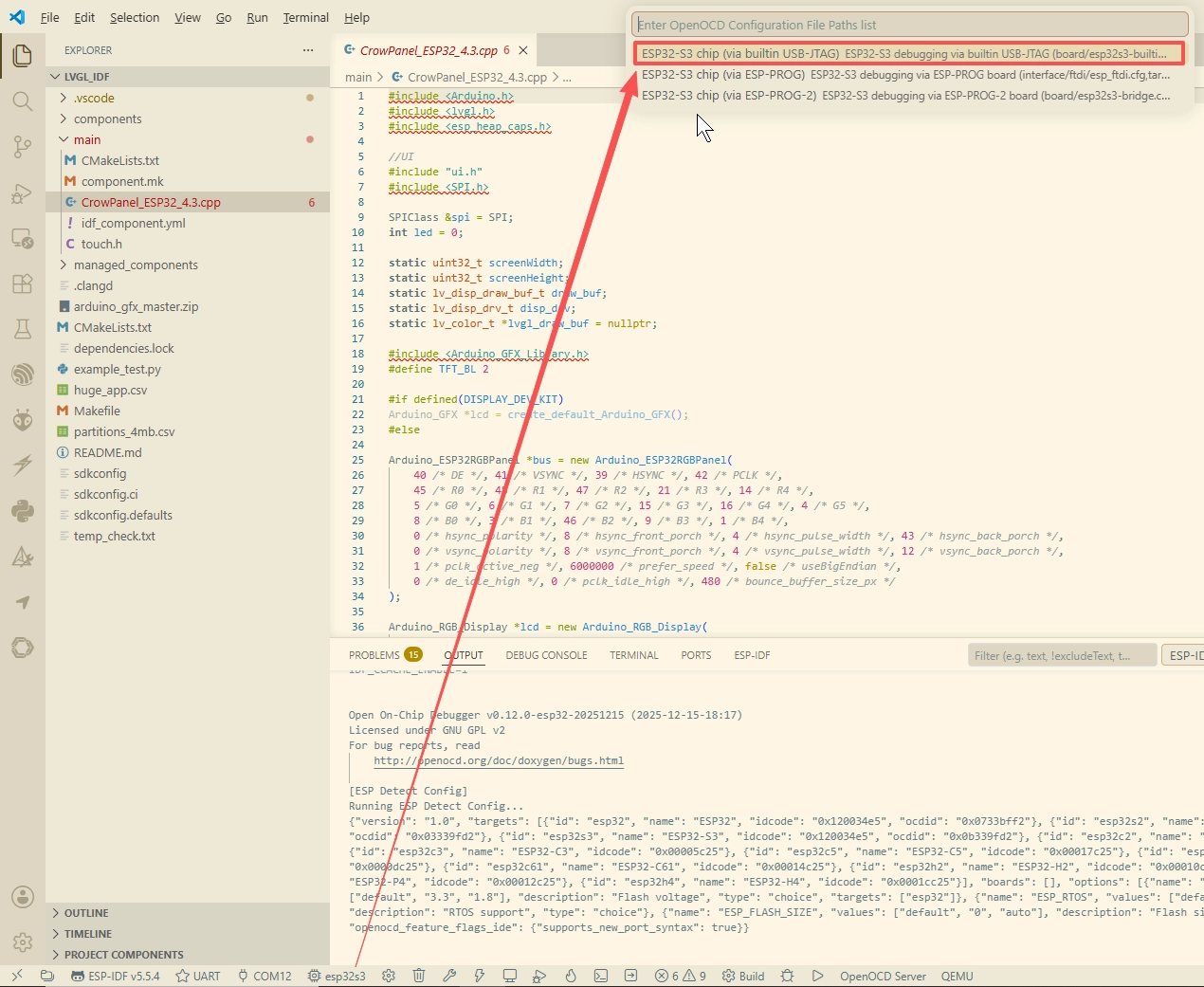

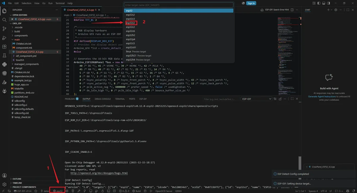

Setup board¶

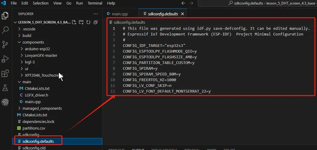

Menuconfig Setup section¶

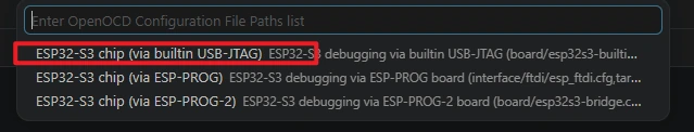

Click Menuconfig to enter the Settings
Flash memory setting
Partition table setting. The second point requires manual input.
ESP32 setting
LVGL setting, uncheck
Save the setting

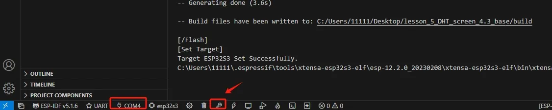

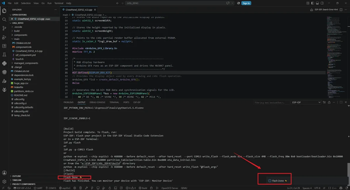

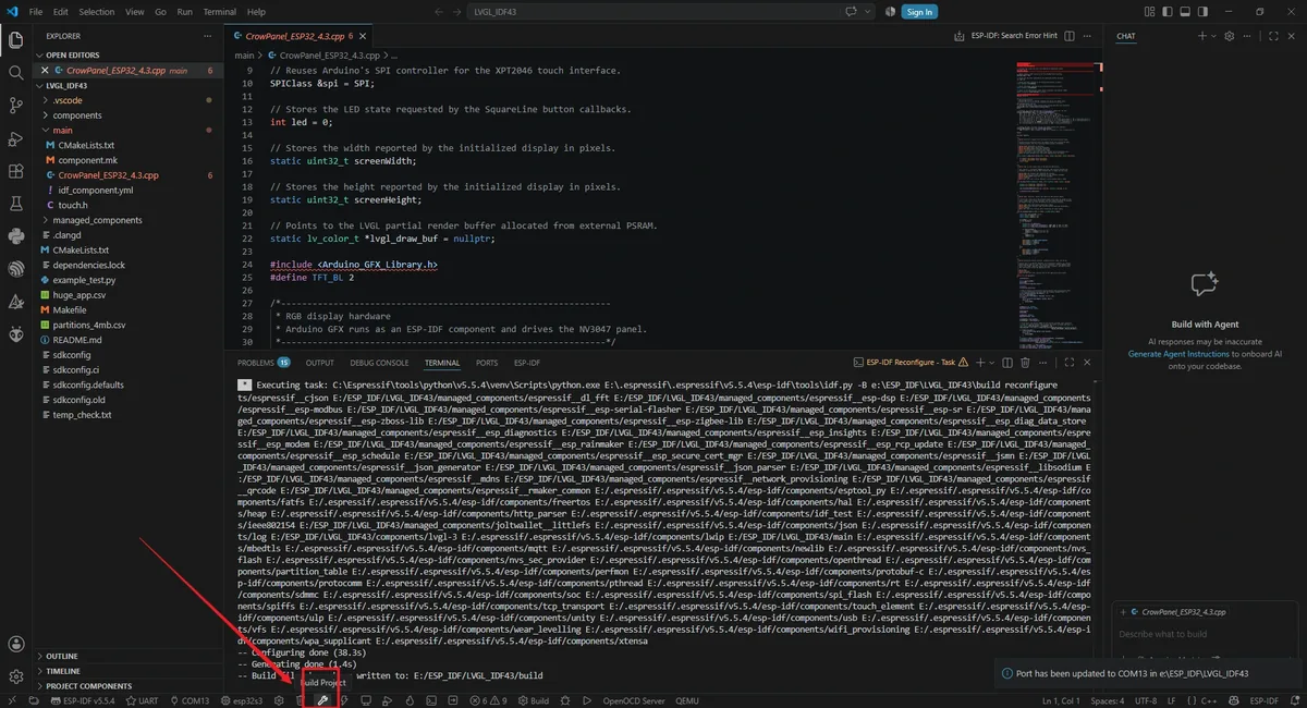

Download the program¶

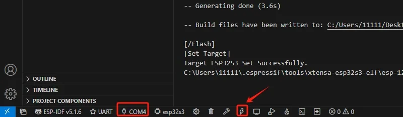

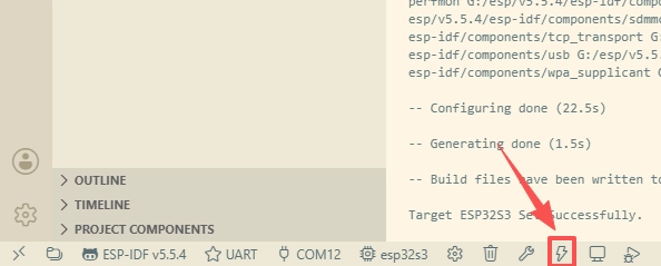

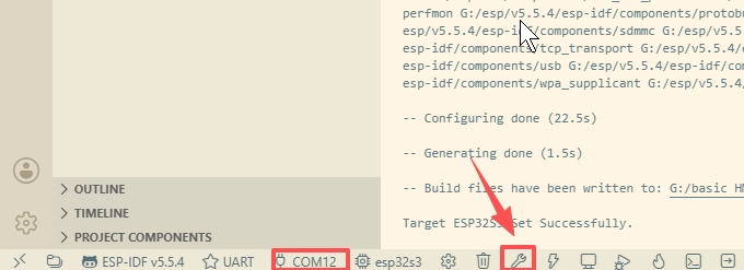

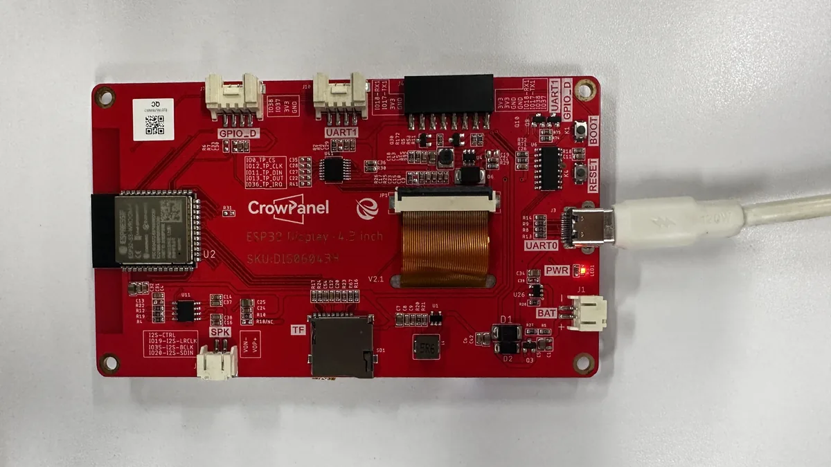

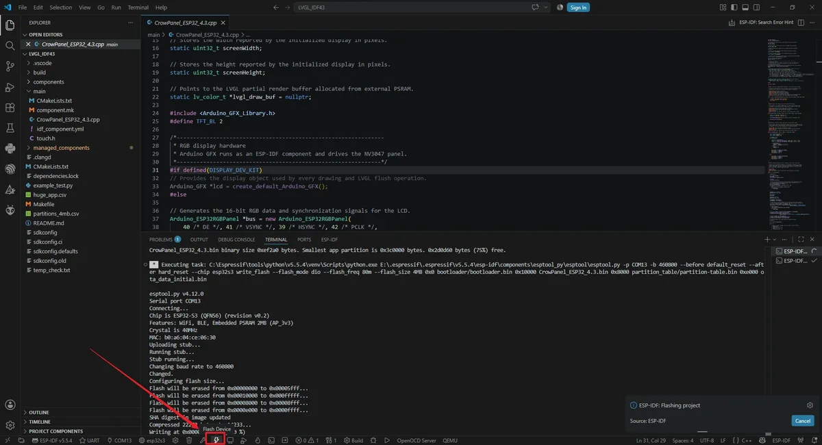

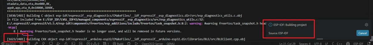

Connect the ESP32 Display to the PC and compile the program.

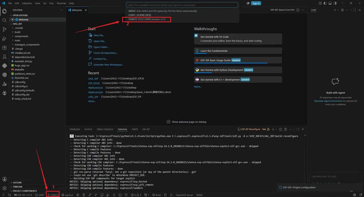

After confirming the serial port, select the UART mode.

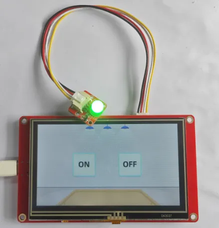

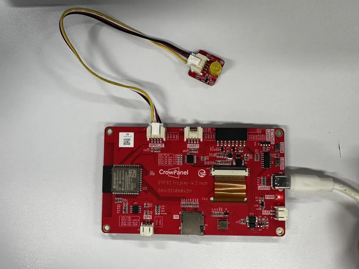

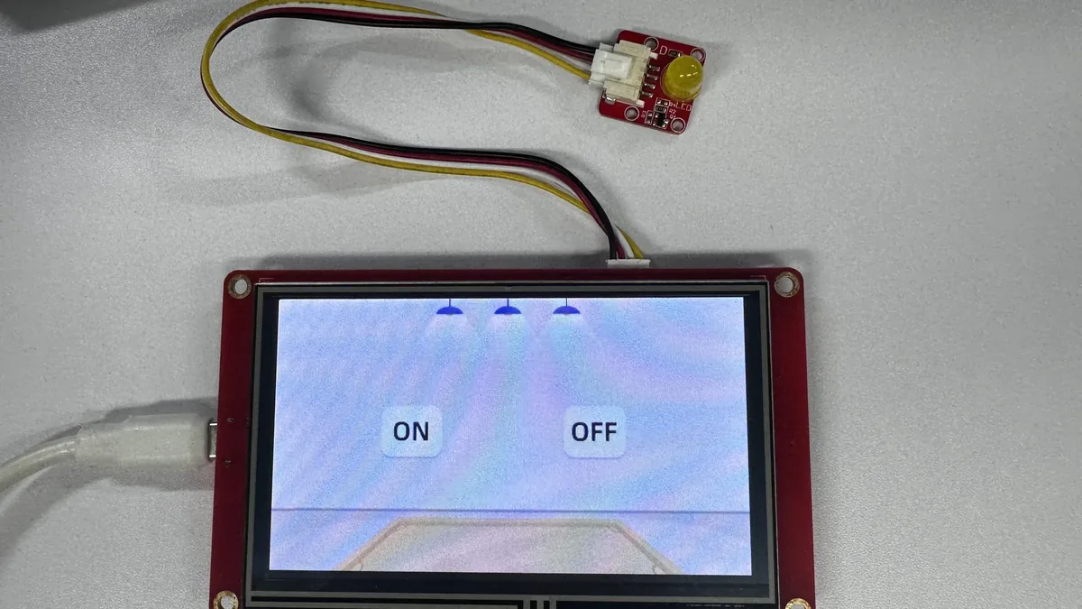

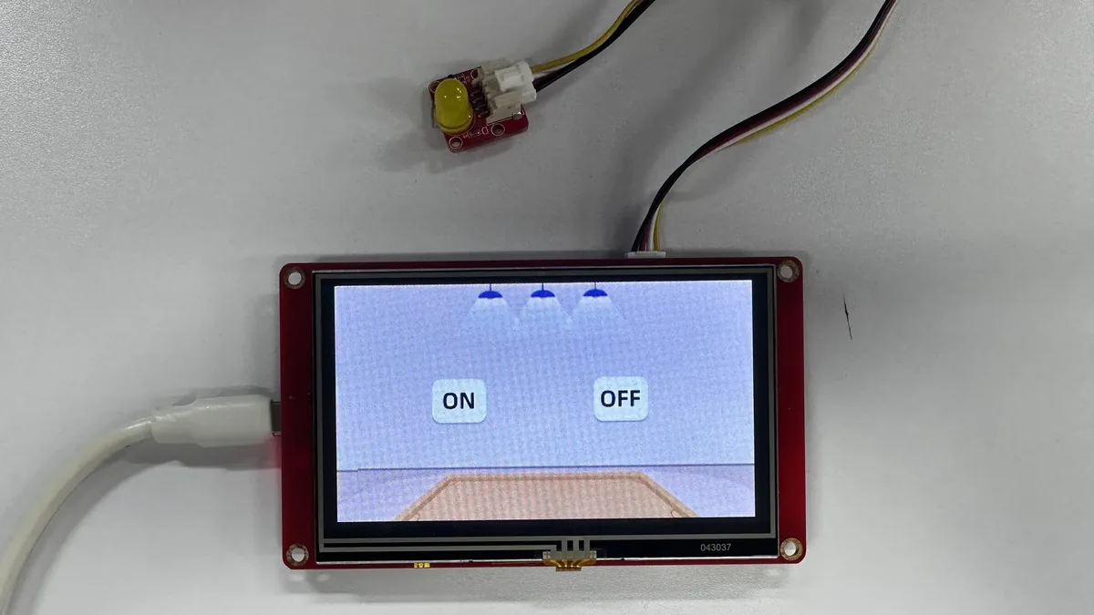

After the program is successfully downloaded, connect the LED to GPIO_D. Click the ON button on the screen and the LED will turn on. Click the OFF button and the LED will turn off.
